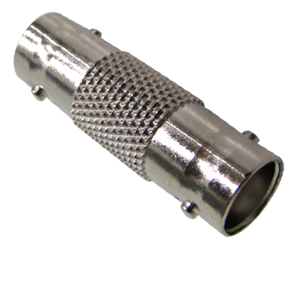

Dr3am 0 Posted December 15, 2012 Hi I'm upgrading a system at a property that already has 16 cameras using RG59 Siamese cabling. The power supply and DVR are in 2 different locations but the video leads to the DVR need to be extended about 15 feet further than where the old CPU based DVR was located to a rack. What would be the best way to extend the wires without using the BNC barrel connections? A few times I have used those things there is always intermediate video loss. I have even tried ordering different types of barrels from different vendors with the same result. Any input would be appreciated. Share this post Link to post Share on other sites
the toss 0 Posted December 15, 2012 If you have room on the rack ( 1U ) then install a patch panel with panel mount double female BNC. Then make up a bunch of 15' patch cables. This will not overcome your problem with insertion loss which will remain at about 1.5dB but if this is of importance then you have other design issues to address Share this post Link to post Share on other sites
Dr3am 0 Posted December 15, 2012 well the rack is 15 feet away from where the old CPU based DVR is located now and I need to rack mount the new stand alone DVR about 15 feet away from there to the rack. If the wires where already at the rack I would not need to extend them. Share this post Link to post Share on other sites
GrouchoBoucho 0 Posted December 15, 2012 i've used barrels on dozens of jobs to extend cables, never had an issue with them. either you're using really junky barrels (or even the *wrong* barrels - make sure they're designed for 75 ohm impedence), or your terminations aren't done properly. there really is no other way to do it *properly*, short of running new cables. edit: one other thought, one thing i've done on a couple occasions, when extending pc-based dvrs that use the 'whip' cables, i've used vga or dvi extensions (depending on which connector the whip uses), then just left the whips connected to the cable runs. it may or may not work depending on the actual pinouts the dvr uses, but it's worked for all the dvrs i've tried it on. of course, if you're going to a standalone dvr without the whip cable, this isn't an option. Share this post Link to post Share on other sites
aibudo 0 Posted December 15, 2012 If it was me and didn't want to deal with BNC to couple the extension to, I would just use F59 connectors and F81 barrel connectors, as I've never had an issue with them. Dennis Share this post Link to post Share on other sites
Dr3am 0 Posted December 15, 2012 If it was me and didn't want to deal with BNC to couple the extension to, I would just use F59 connectors and F81 barrel connectors, as I've never had an issue with them. Dennis That sounds like a good idea. I use the F81 barrels on my satellite installs all the time with no problems. Guess ill pick up some F59 connectors. Share this post Link to post Share on other sites
