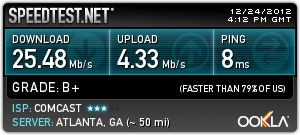

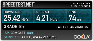

riggz 0 Posted December 24, 2012 Here's the results. I am located just north of Atlanta, GA: Local: Cross Country: Share this post Link to post Share on other sites
