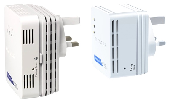

tomcctv 190 Posted January 5, 2013 hi. another way would be to use your existing cat5 with baluns for just your cameras and use netgear over power for your temp control gear Share this post Link to post Share on other sites
