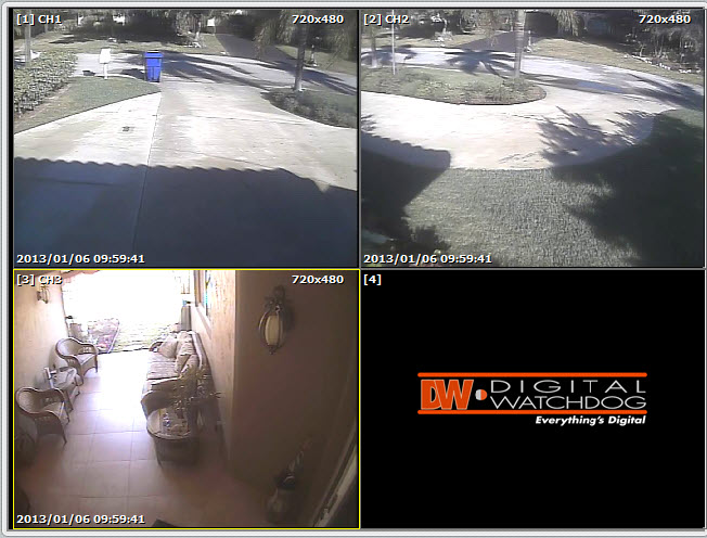

I had a recent break-in attempt at my residence and my current security system captured some halfway useful pictures for the local law enforcement agency but I now decided to upgrade to something higher resolution and IP based. I'll be doing it in two phases with the front of the house being first.
These are the three cameras in the front today, they are facing north, so no direct sun hitting them but the backlight on the front door camera is quite strong and the other two cameras have large shady areas during the winter time. At night the front porch lights stay on all night so no IR needed there. There is a street light on the left property corner and garage lights that stay on all night but the right side has no lights.

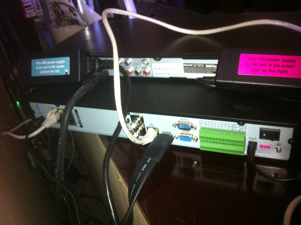

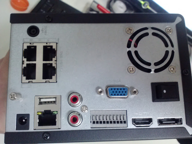

am i ...... take unit apart and SEE how many power units there are 1 which runs nvr and built in switch.
sold lots
I have done this already at one location
see so i am right un reliable so why pay for it. external POE is alway best.
The POE NVR's that I have installed have two power cords that plug in. One for the camera and one for the NVR. I removed one camera b/c it was not getting enough power to run all 4 cameras. I am not sure why on this one system but the other two work fine. I think the Cat5 cables could have a short in them as well and I will be replacing those next. To say the NVR is dead if the POE goes is wrong though.
