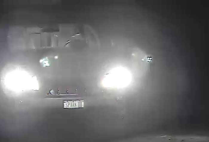

Here is example
Avigilon camera is about 200' away
with IR shooting at Lic plate
and sample when you zoom in using software
One of the number on Lic plate was removed for forum

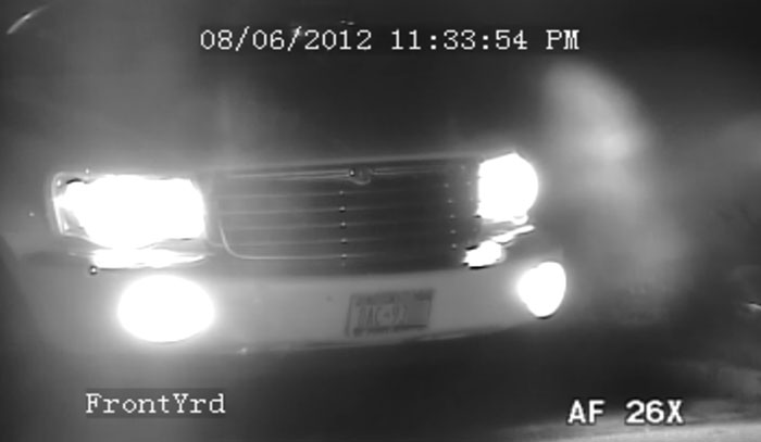

Here's some from the cameras I use. If you have an analog system, I like a quality ptz to help with LPR. But you gotta be on it with the camera mostly, not running out your front door. Or, you could dedicate a preset position for it.
From the Dahua, arrow security about 140' on an angle pulling away-
This is from my home PTZ, and Inesun camera [Hong Kong]. 150' zoomed in, my 'shady car' episode one night. Plate number obscured-
Dahua 250' zoomed in, plate obsured-
This is one is the Dahua. It's me parking with the inside dome on. I didn't realize it until I played back the file how perfect the shot is. Perfect, but extremely unlikely you can catch a shot like this on the fly-
I linked to it a couple posts up. I have the 700tvl 23x version. It's been excellent.
Btw- I found another shot from my Inesun ptz at home of that car, only this shot has the IR on- a great shot as well.
