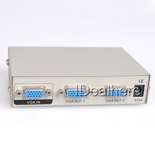

seaotter69 0 Posted January 14, 2013 Hi all, new to site. recently fitted a 6 camera setup via kgauard h.264 dvr pack. only has 1 vga output, works great with 1 screen but used a splitter to run a second screen, but now has rolling blackish lines on both screens. is this just cos of low signal from splitting the one output ? and will a signal booster cure the problem ? kind regards steve. Share this post Link to post Share on other sites
GrouchoBoucho 0 Posted January 14, 2013 i assume you used one of these? yes, splitting the signal this way will cause problems, as each monitor is only getting half the signal level. use an *active* splitter instead. http://www.screencapturenews.com/2009/10/15/vga-splitters-explained-active-or-passive/ Share this post Link to post Share on other sites
seaotter69 0 Posted January 14, 2013 yes you are correct, thought it might be the case, cheers for confirming this. Share this post Link to post Share on other sites
