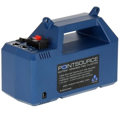

buellwinkle 0 Posted January 27, 2013 I've used a Veracity Pinpoint, about $60. It takes the Ethernet with PoE on location and splits it so you can attached a laptop and the camera at the same time from the one connection and then connect to the camera to aim & focus it. Share this post Link to post Share on other sites
Jomadav 0 Posted January 28, 2013 buellwinkle. I like the idea of the Pinpoint (looked at it on Amazon). Is it that straight forward? We have laptops. Can I just take an IP cam that is powered up and use a Pinpoint to split it? or do I need software / other parts?. Thanks for the tip. Share this post Link to post Share on other sites
thewireguys 3 Posted January 28, 2013 No software is needed just plug your laptop in and access the web browser of the camera. FYI I have like 3 of these which I never use because I find them to be to inefficient. 2 guys with a radio is much faster. Share this post Link to post Share on other sites

survtech 0 Posted January 28, 2013 Jomadav, I have checked and haven't found any computers, laptop, notebook or otherwise, capable of providing POE from their Ethernet ports. You have to provide camera power in some other manner, either from a POE switch or inserter, the Veracity Pointsource or, if the camera can accept it, an external power source. Share this post Link to post Share on other sites
thewireguys 3 Posted January 29, 2013 The other option that I have used is a wireless network. Most customers don't have a network that can handle the video or don't have on at all so I normally have a Ruckus AP on me that I use for our own network. I also agree the Veracity Pointsource is very useful tool. Share this post Link to post Share on other sites
Jomadav 0 Posted January 29, 2013 I use PoE injectors on other longer stuff. I suppose I could use one for this with a cord. Issue being if no IP info or switch locations are identified at the time of install, I/ we have to work around it. SO, if I look at this correctly, a IFS PoE injector and the PointSource at the camera with a laptop should skin the cat. No? Side note....this is alot of screwing around to provide power. Can't a guy find the PoE standard and make a RJ45 adapter that provides power on the correct pair? - I know, alot of variables...just seems like it should be that easy. Share this post Link to post Share on other sites
thewireguys 3 Posted January 29, 2013 All you need is a camera, Point Source, two patch cables and a laptop. Share this post Link to post Share on other sites
Jomadav 0 Posted January 29, 2013 OK, forgive me. When I said Point Source I meant PinPoint. Both Veracity. Difference being PointSource provides it's own power and PinPoint needs to be powered. I miss spoke. Same idea though? Share this post Link to post Share on other sites
thewireguys 3 Posted January 29, 2013 It is actually very easy to make your own Pinpoint but you need power anyway Share this post Link to post Share on other sites
Jomadav 0 Posted January 29, 2013 I think your right. Ill make some calls in the morning and see what is local here first. Thanks for all the help. I think I have enough now to go on. I appreciate it. Share this post Link to post Share on other sites
