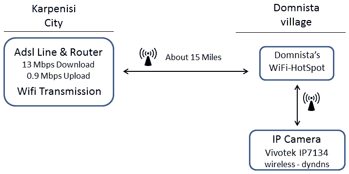

You can see the basic setup in this image

no its not >>>> but where are you going with your camera before it goes out to internet ???
The camera is wireless. And it is wirelles connected to the hotspot.
HOTSPOT...... ???? direct to camera ... so your not using a router
Take a look at the first post. There is a diagram that explains the connectivity.
