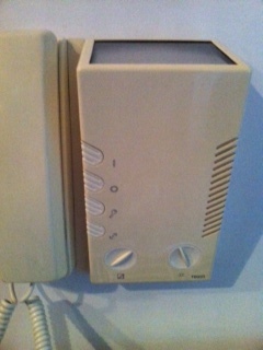

I would like to know if anyone has tried connecting the door bell intercom (camera) with a DVR.
I have a 16ch dvr and I would like to have view of my entrance from the intercom camera at all time
Is it possible?

Is there any way so I can found out this? I opened my intercom and I saw 4-5 cables and one larger cable (like TV cables).
I tried connecting this larger cable with a bnc and then with a bnc cable to my dvr but I had no picture.
Make and model of intercom? Check the manufacturer's website or contact them about getting an external video output.
a system of that age probably uses coax. However you will have to check the video termination.
Cameras on door entry sstems are often powered only when the handset is lifted or there is a call from the door - have you checked that?
The house is from 2003. In order to open the camera I have to press the third button or someone ring by bell.
