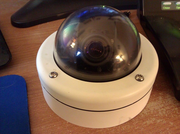

Brenton81 0 Posted February 1, 2013 Are you talking about one of these little guys? All you should have to do is take the bubble and liner off, and rotate the camera so it's right side up. Share this post Link to post Share on other sites

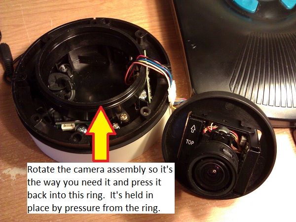

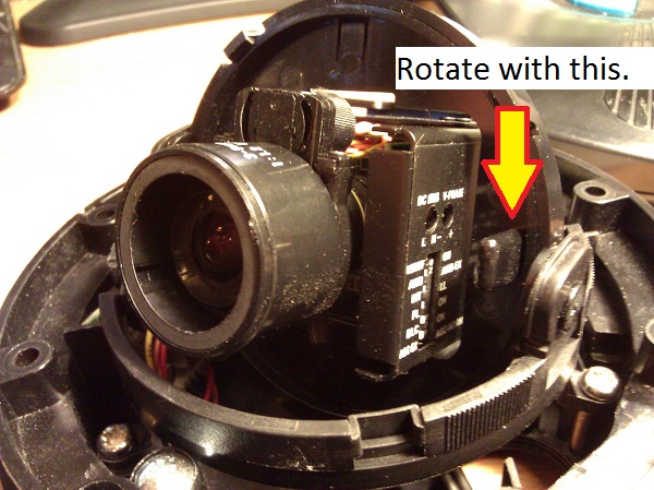

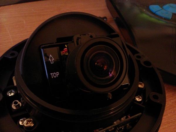

Brenton81 0 Posted February 3, 2013 Not silly at all. There are two types of these domes. On the older ones, the whole camera assembly just pops out. All you have to do is flip it to the direction you want and press it back into place. It's held in place by pressure from the large plastic ring. On the newer version, the camera assembly doesn't come out. There are to small plastic tabs on each side of the camera. You simply use them to kind of grab on and rotate the assembly the way you want it. Hope this helps! Share this post Link to post Share on other sites
halsaps 0 Posted February 3, 2013 Not silly at all. There are two types of these domes. On the older ones, the whole camera assembly just pops out. All you have to do is flip it to the direction you want and press it back into place. It's held in place by pressure from the large plastic ring. On the newer version, the camera assembly doesn't come out. There are to small plastic tabs on each side of the camera. You simply use them to kind of grab on and rotate the assembly the way you want it. Hope this helps! thanks that was vv helpful will have to try it out in the week hopefully. Share this post Link to post Share on other sites
