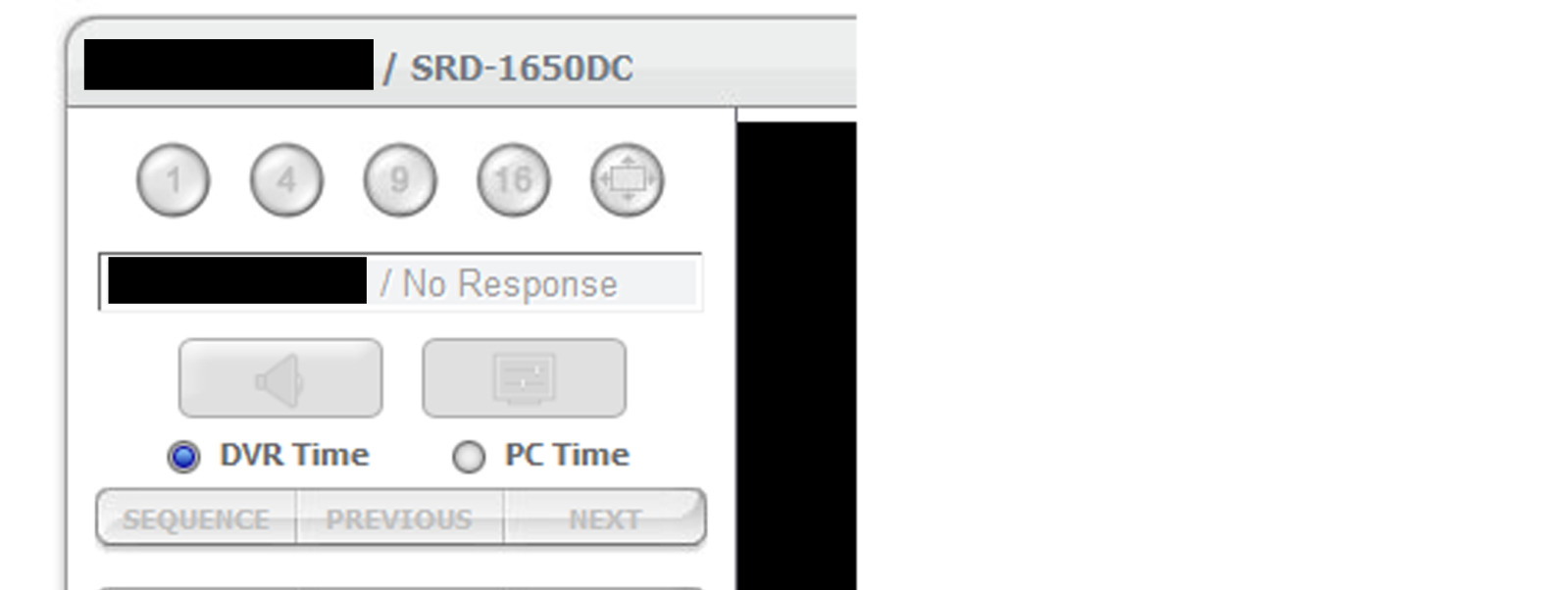

Attempting to setup the webviewer for samsung SRD-1650DC. Below is the situation I have so far.
Internal IP access works perfectly (192.168.1.xx) brings up the login screen, when logged in, CCTV feeds are displayed.
When attempting to access using our routers Port Forwarding (using our static IP, forwarded to the internal IP 192.168.1.xx port 80) - login screen appears but when logging in I receive a message 'No Response' (See image below).
This also occurs when I use Samsungs DDNS service.
any ideas?
Is "port 80, the only port that you forwarded? If so, that's probably the issue. Some DVr's have up to 3 more ports to forward, ie;
Command
Media
Mobile
