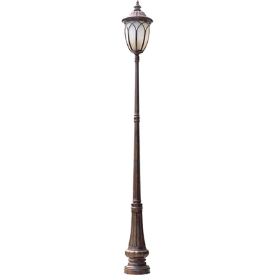

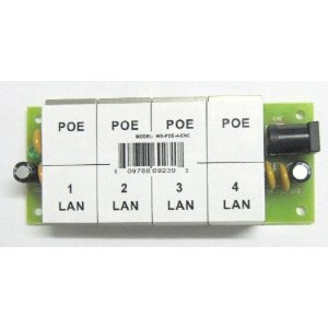

Each light pole has 120v power lines running in. I would like to use this power to power a POE Injector 212980_2.jpg. Which I will use to power the IP Cameras, perhaps the Dahua's avail from costco www.costco.com/Q-See-High-Definition-720p-2-Pack-IP-Cameras.product.100003461.html.

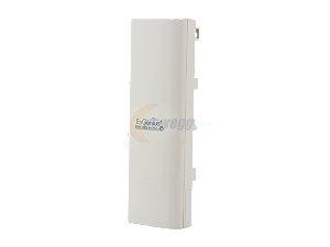

The data will be sent back to network via the Engenius wireless bridge 212980_3.jpg
What I've not yet figured out is how I connect two cameras in this setup...
