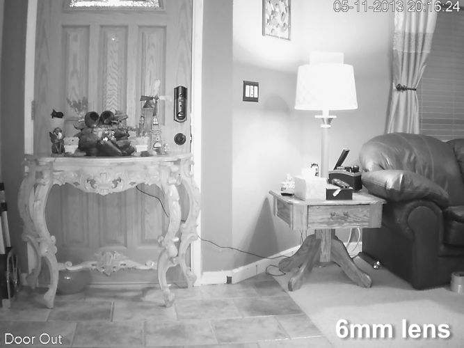

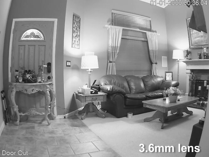

90beater 0 Posted May 12, 2013 The field of view is quite wider than I had expected. Here is a before and after from 10 feet. Share this post Link to post Share on other sites

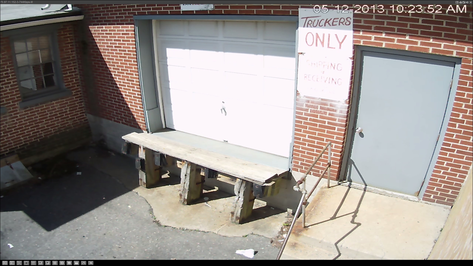

Kawboy12R 0 Posted May 12, 2013 I'd expect less distortion on a 3.6mm lens. That's quite the fancy boobytrap in front of the door though. Nobody sneaking in through that one without making some noise... Share this post Link to post Share on other sites

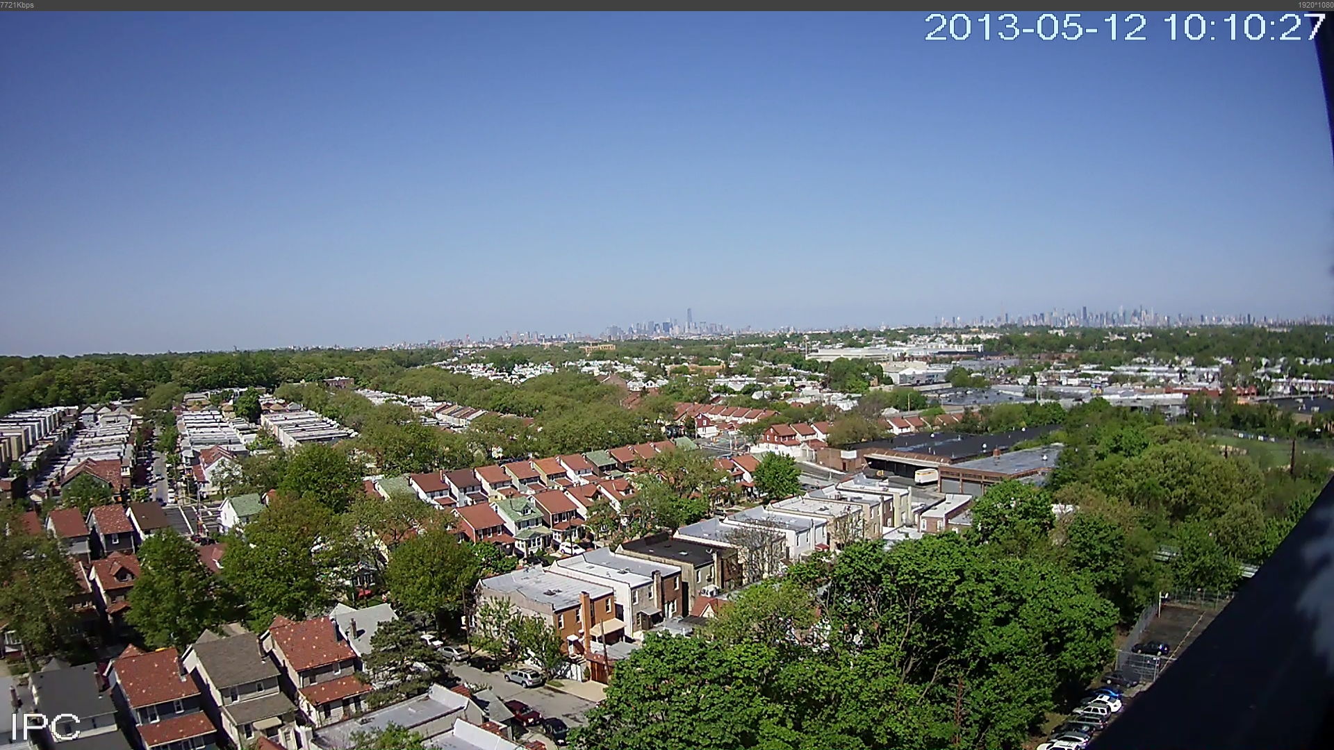

vector18 1 Posted May 12, 2013 I'd love to see an image comparison between the dahua 3.6 lens and the anykeeper 3.6 lens. So, what is the FOV from a 2mp with a 3.6 on the 15th floor? LOL. Share this post Link to post Share on other sites
vector18 1 Posted May 12, 2013 or a 1.3mp with a 3.6 a few feet away about 15 feet high? Share this post Link to post Share on other sites
