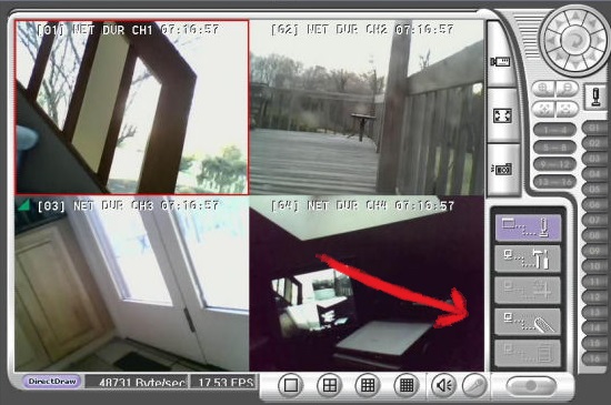

I downloaded the remote console yesterday from the AverMedia site. It's screens seem quite different from the old version I had been using. In the setup I noticed that the network setting dialog box seems to cover an area that has "Language" in the background (see SetupScreen.jpg). And when I select Network, the authorization box looks a little strange (See RemoteLoginAuthorization.jpg). And when I try to login, the connection fails with the error "Connection Server Failed."

I just tried this, and realized I hadn't connected remotely on this PC since changing NV PCs when I switched from an NV5000 to an NV6240-16 and updating to 7.9.0.0029 software. It didn't work (probably user error, since I don't use this much), so I uninstalled and re-installed, then figured out what I was doing wrong. It gave me various file access errors when I tried a re-install over the existing uninstall.
On mine, I don't see the weird window issues you show, and it connects fine when I set up the IP/port and click Network. I also selected autologin, and that works fine too.
Your System Setting window seems to have dropped some periods in the IP address - dunno if that's the screen cap, or real, but that could cause it. You can double-check that by looking in the \Program Files (x86)\remoteAP\DVR00.INI file, [Network] section, and checking that the IP address and other settings are correct there.
My first Aver NV install had trouble due to the video driver, and updating it fixed everything up, so that may be worth a try, given the screen problems.
