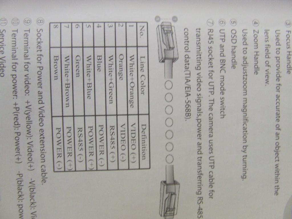

in the manual for the camera and it says "the camera has a RJ45 socket for UTP,the camera uses UTP for transmitting video signals,power and transferring RS-485 control data"
andrew
The camera is the one you linked above? Because that one is an analog camera, and it does not say anything about RJ45 or RS485.
here's a pic of the manual
It does have RS485, so you can indeed control the OSD menus from the DVR!

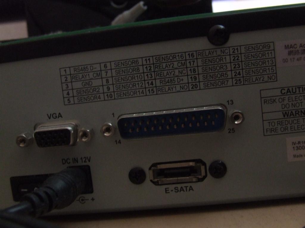

more help needed please,
is there an adapter available to convert the connector(25 pin) on the back of my dvr(as seen in pic) to a rs485 connection
thanks andrew
