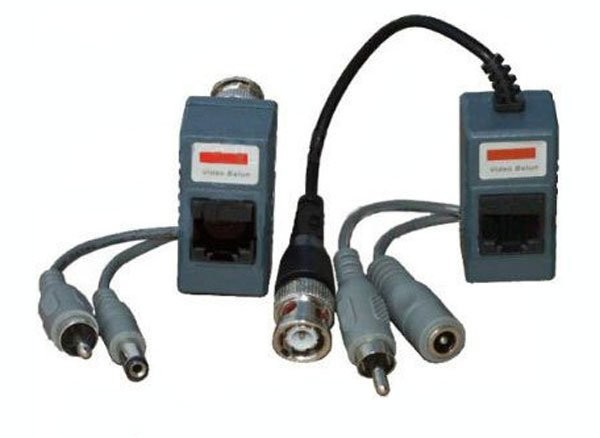

gvorn 0 Posted March 12, 2013 Hi guys. I`ve recently installed at home a small cctv camera. Very basic: - One cctv bullet camera of 420L (CCD 1/4" CMOS 420L 3.6MM INFRA 24 LEDS 0 LUX - model CTD-347) - A pair of video baluns with BNC and Power to RJ45 - 48 meters of UTP Cat6 cable It all connects to a LCD Television to view the image (no recording device). The sistem has been working for at least two weeks with no problems. Now a problem appears! The camera is showing a complete White Image with some shadows behind that i recognize as the place the camera is pointing. - I`ve tested with news baluns and the problem remains. - When connect directly to tv, the problem remains (and sometimes the home electric board crashes when i connect) - When connected to a tv card on computer it works fine Any ideas? The thing that makes me thing is the two weeks it all worked fine I`m considering to introduce a "balun ground loop isolator" next to the camera to see if it gets better. Share this post Link to post Share on other sites
