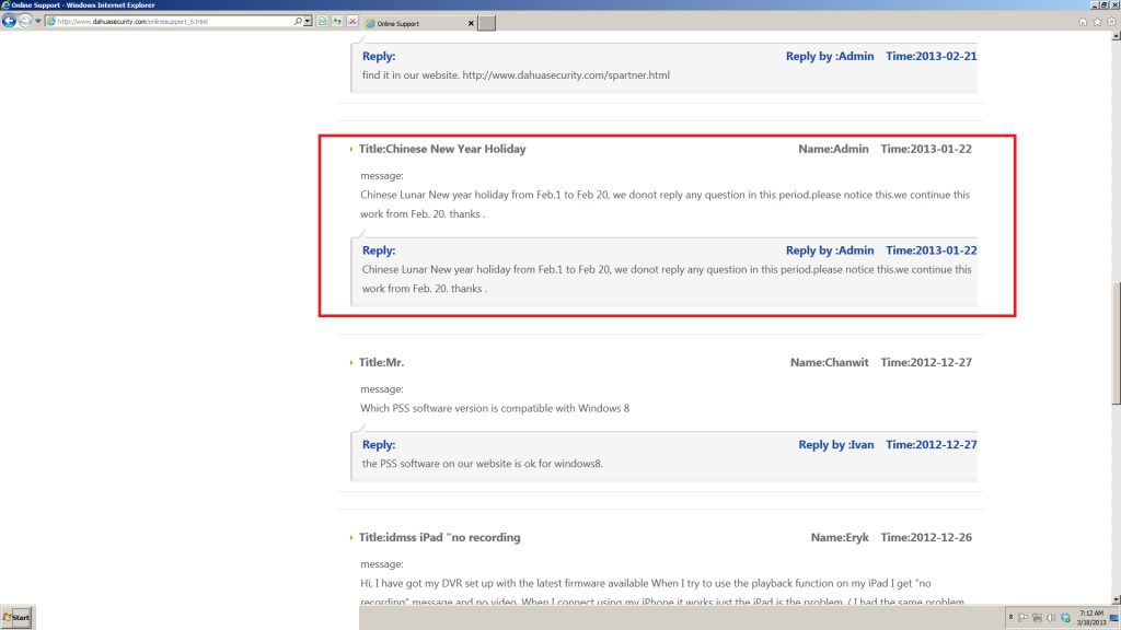

WRS_Mark 0 Posted March 18, 2013 Just out of curiosity, does everyone who is supplying this Dahua equipment disclose to the customer that factory tech support goes on holidays one month out of the year? Share this post Link to post Share on other sites
