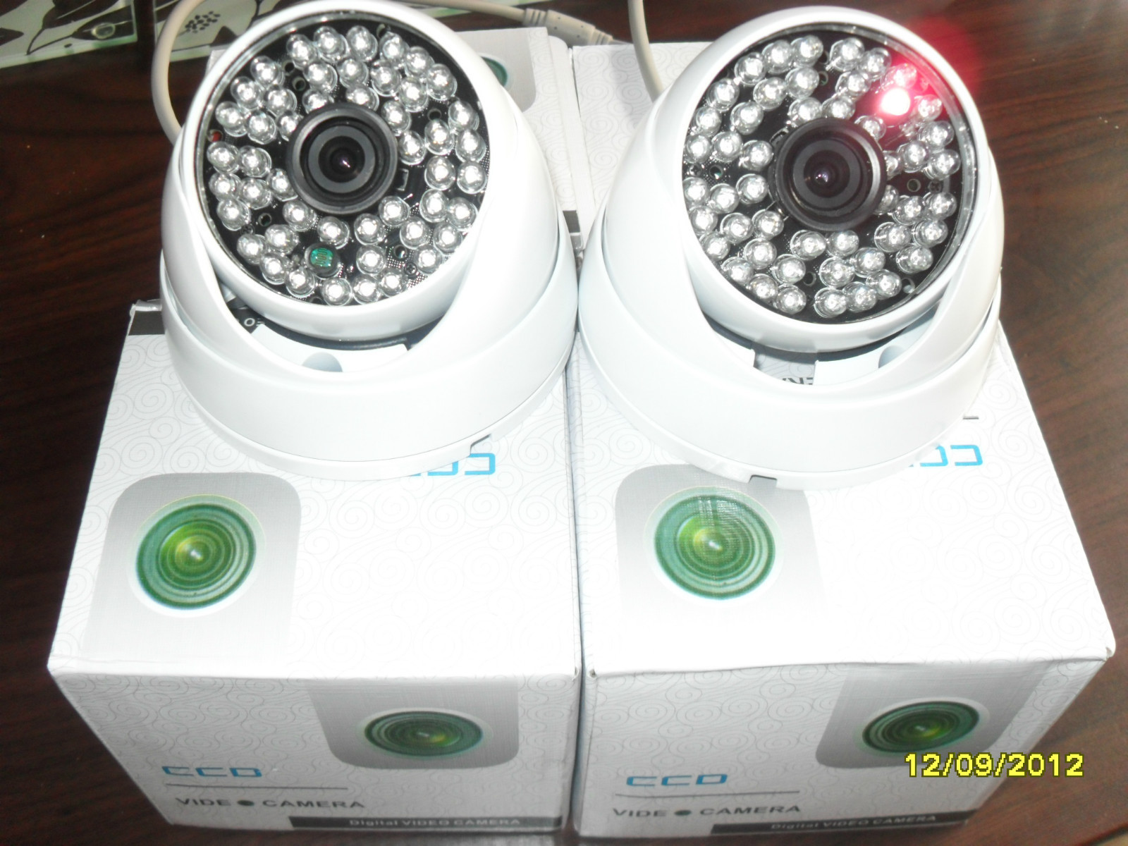

HellRaiser1st 0 Posted March 17, 2013 hello everyone i just installed my cctv system last week and i have been having a problem with my cameras. the problem is that my night vision LED do not turn off during daylight they are always on, the light sensor is functioning properly as i see coloured video during day light and normal night vision during night time, the problem is that everyone who is dressed in black comes out purple during day light and my leds are always on and the cameras draw to much attention with 48 red led's. is there a way to turn them off ? my standalone dvr has no option for night vision on/off i don't know what to do, is it a problem with the cameras or i bought a crapy cheap useless dvr system ? here is the cameras i have bought: and here is the picture of the dvr i bought: Share this post Link to post Share on other sites

HellRaiser1st 0 Posted March 17, 2013 both cameras are the same on the bx for the cameras i only have CCD video camera written on it nothing else and at the back of the camera i have the qc sticker, pal sticker and thats it Share this post Link to post Share on other sites
shockwave199 0 Posted March 17, 2013 Well there you have it- non TDN cameras. So, you'll now begin the quest for better, TDN cameras. Share this post Link to post Share on other sites
Kawboy12R 0 Posted March 17, 2013 I hear you on the cheapo non-true day night camera thing, but what's the green dot down low amongst the LEDs on the left-hand camera and the reflective red flare on the right-hand camera? Light sensors on cams with no IR cut filter? Share this post Link to post Share on other sites
shockwave199 0 Posted March 18, 2013 Reflection and camera flash glare? Maybe he's got a red eye thing flashing when he take a pic. Share this post Link to post Share on other sites
Securame 0 Posted March 18, 2013 If the leds are always on, I would say those are defective cameras. Image might be better or worse depending on the camera quality, but the leds should turn off when the ambient light is enough to work in colour mode. Share this post Link to post Share on other sites
