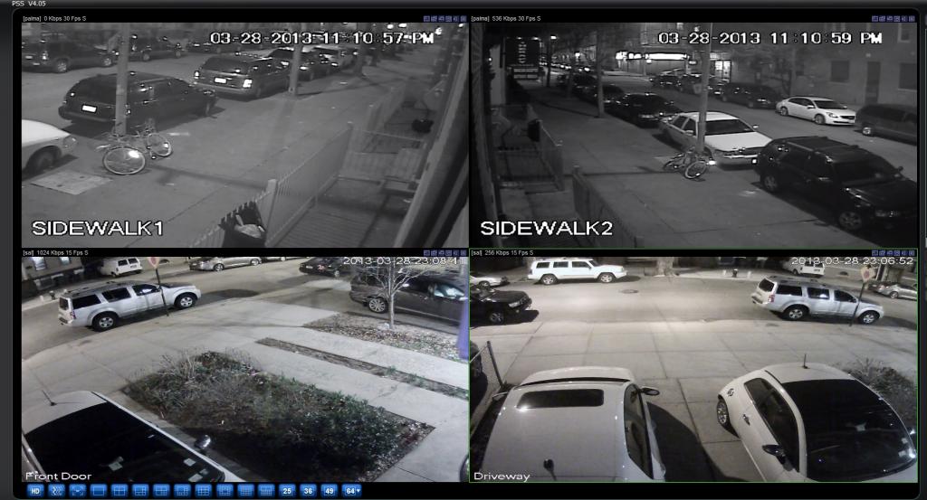

vector18 1 Posted March 29, 2013 The two top cameras are analog IR cameras that I actually spent more money than the IP cameras in the two lower boxes. They are all live shots viewing at the same exact time of day. So, please, if your going to bring up the night vision comparison between analog and IP, back it up with images. The images I am producing basically is my proof that IP night vision is better than analog night vision and it does not cost any more money than analog does. Share this post Link to post Share on other sites
Mrcarcrazy 0 Posted March 29, 2013 Not to be an ass..but...not really apples to apples. Also I've noticed by looking at a bunch of older cams that they had better night image before they started adding IR to them. The older cams that would just go black when lighting was terrible had much better image quality. Now the cams try..but it looks like crap. So u don't know that your camera isn't getting enough light...instead you assume that the camera just isn't up to the task. And to clarity I'm assuming the OP is talking about megapixel cams when he says "IP". Look at rorys old images. Your comparing ONE megapixel cam to ONE vandal dome.... The question is kinda a tricky thing and cannot be answered as simply as any of us are trying to claim. Share this post Link to post Share on other sites

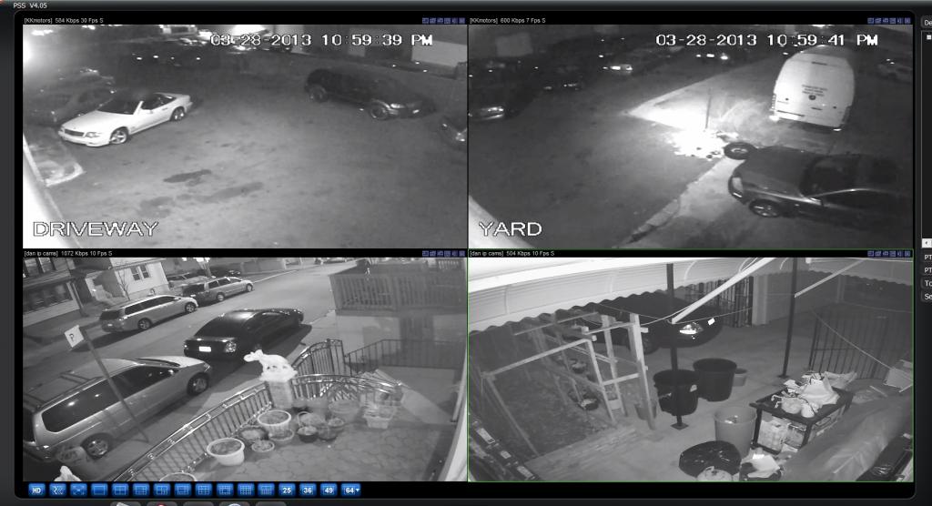

vector18 1 Posted March 29, 2013 another comparison, top two are analog and bottom two are IP Share this post Link to post Share on other sites
Mrcarcrazy 0 Posted March 29, 2013 (edited) Cat5 and baluns? I've seen 50.00 cams that beat your MP cams at night. (If u look on this very site, you will too...) ever tried a black and white camera? Here's a link with some decent night shots out of very inexpensive cams. http://www.bahamassecurity.com/cctvforum/forum_posts.asp?TID=39&title=cctv-camera-comparisons-images I'm not really into the special Olympics. So I won't try to convince you that your arrogance blinds you. Carry on. Edited March 29, 2013 by Guest Share this post Link to post Share on other sites
vector18 1 Posted March 29, 2013 not to be an ass either, but no one is saying apples to apples. The original OP is basically trying to get a feel what others prefer as far as quality, durability, ease of use, as he had mentioned in a previous post. Someone mentioned that analog produces a better night image for less money and I simply posted an example of spending more money on an analog camera compared to an inexpensive IP megapixel camera and getting a better image at night with the IP camera. Yes, I agree, there is no simple answer to, which one is better. Obviously, IP megapixel is better, but there are categories that can be brought up where as analog cameras would be the preferred choice. Share this post Link to post Share on other sites

vector18 1 Posted March 29, 2013 and keep in mind, some inexpensive analog cameras may produce an excellent image with some aide from lighting, but what happens when you want to digitally zoom into something to get alittle more detail? And what happens with that 5mp camera when you digitally zoom into something for detail? Share this post Link to post Share on other sites
shockwave199 0 Posted March 29, 2013 If you're gonna post night images- something I like btw, please post useful night images of people in the shot. Backup footage of people walking. Stills from backup footage of people. People zoomed in for that detail, from backup footage, that's always mentioned. It's gets tiring looking at images of parked cars and driveways. The ULTIMATE goal is not just a pretty, clear picture, but how much improved the ID shot will be. Night images- or any time- void of ID examples doesn't show anything more than clean pictures of static objects. The other thing to consider is location. Maybe a busy street is void of spiders on the IR's but I can assure you that on a residential house install, close up megapixel shots of webs and spiders isn't what you want. So out goes MP IR cameras, in comes other considerations- be it analog or MP. MP cameras absolutely provide better resoltion, but a heck of a lot more goes into the equation for ID than just that. And one mans great result with MP cameras doesn't mean it's the better choice for another. Oh, and it would be great to see how well faces hit with IR from the megapixel cameras handle that. No matter what camera has IR in it, if the intensity doesn't self adjust it becomes a useless face wash at the most critical time- a close up shot. Share this post Link to post Share on other sites
