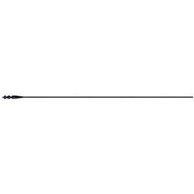

The main problem with flex shafts is that it is difficult to keep the drill going in the right direction. For holes down through walls and up or down, I prefer to use flexible bits, which are drill bits with very long semi-flexible shafts, like this:
Auger bits are a bit easier to use in wood because once they are started, they tend to pull themselves through the wood, rather than requiring force.
