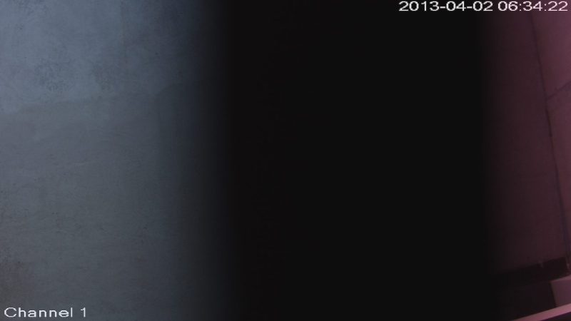

Chob 0 Posted April 2, 2013 Ok, will check it tonight. About the motion detection when he switches from day to night and vice versa, this is how the snapshot looks: Can somebody confirm that this is correct? Share this post Link to post Share on other sites
MaxIcon 0 Posted April 2, 2013 I don't use on-camera motion detection, and my software uses pre-trigger frames, so I get the full clip of a few seconds before the change and 30 seconds after. What yours looks like is the IR filter is partially out of the way, but not completely, which is an interesting piece of timing. The dark band is presumably the frame for the IR filter. I'm not sure how fast the filter transition is, but they're typically pretty fast. Having a high frame rate would make it easier to catch the in-between setting. Traditional still cameras with shutters can do this when using a flash, and it's fixed with what they call synchronized flash, but it's not normally considered a problem with surveillance video. If you can change the trigger time for motion detection, that would prevent this from causing an alert. I set my motion detect trigger at 1 second to minimize triggers caused by bugs and such. Share this post Link to post Share on other sites
dexterash 0 Posted April 2, 2013 The filter has a switch(transition) time of about 1/3-1/2 of a second. It's motorized, not electromagnetic, thus making it slower (and i think less prone to get blocked) Share this post Link to post Share on other sites

MaxIcon 0 Posted April 3, 2013 Yeah, this is normal operation for the IR filter. As it moves, the camera sees it going across the field of view, rather slowly per dexterash, and detects it as motion (along with all the pixels changing color). Share this post Link to post Share on other sites
