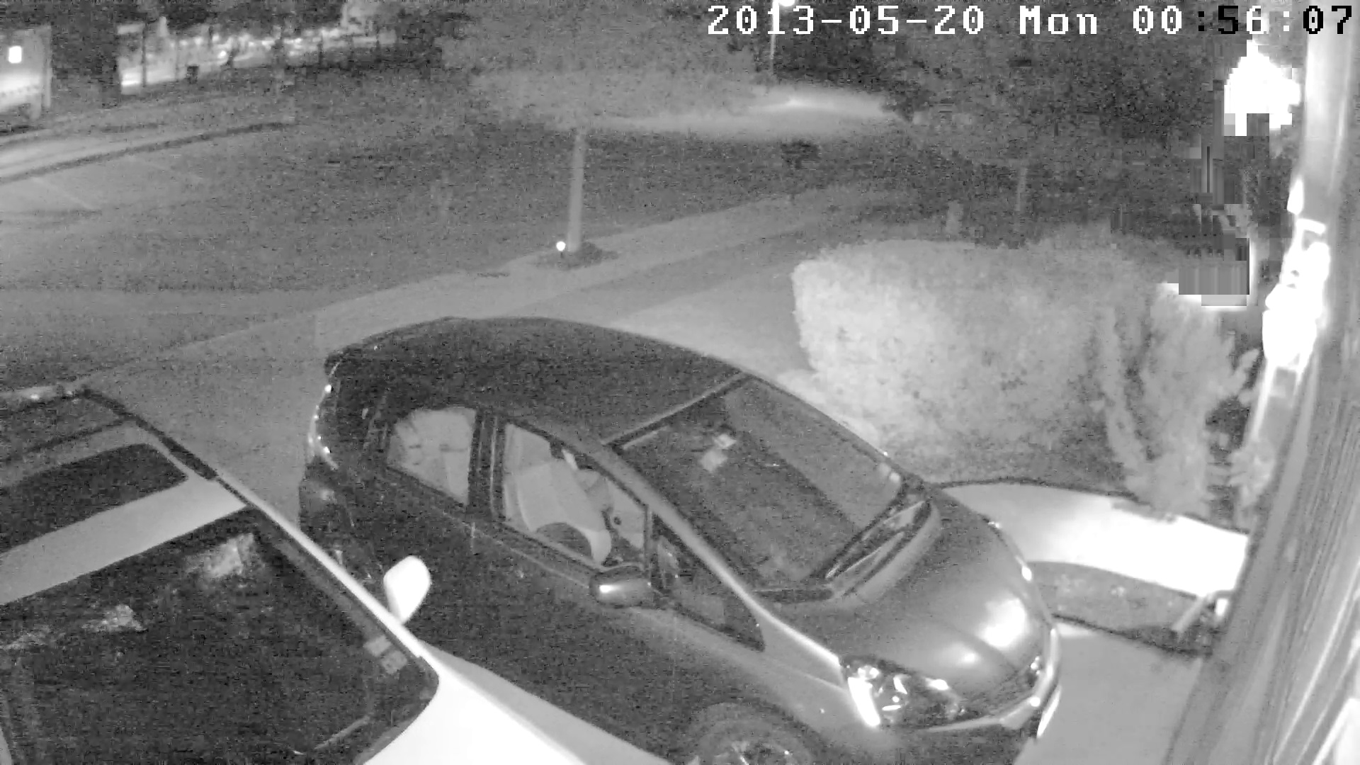

TidalWaveOne 0 Posted May 20, 2013 Why is my Lorex 1080P (from Costco) so noisy at night? Is this normal? The night samples here don't seem to be this noisy: http://www.networkcameracritic.com/?p=1444 Sample: http://www.wiersch.com/jpg/driveway.20130520_005602_1.jpg "Digital Noise Reduction" is set to "Normal Mode" and "Noise Reduction Level" is set to 50. Share this post Link to post Share on other sites
zikronix 0 Posted May 20, 2013 TidalWaveOne said: Why is my Lorex 1080P (from Costco) so noisy at night? Is this normal? The night samples here don't seem to be this noisy: http://www.networkcameracritic.com/?p=1444 Sample: http://www.wiersch.com/jpg/driveway.20130520_005602_1.jpg "Digital Noise Reduction" is set to "Normal Mode" and "Noise Reduction Level" is set to 50. You will need to adjust it for your lighting condiditons. You have sharpness, DNR, and NRL to all monkey with. Swinging one way or the other can drastically improve or degrade video Share this post Link to post Share on other sites
JoeyJoey 0 Posted May 20, 2013 zikronix said: TidalWaveOne said: Why is my Lorex 1080P (from Costco) so noisy at night? Is this normal? The night samples here don't seem to be this noisy: http://www.networkcameracritic.com/?p=1444 Sample: http://www.wiersch.com/jpg/driveway.20130520_005602_1.jpg "Digital Noise Reduction" is set to "Normal Mode" and "Noise Reduction Level" is set to 50. You will need to adjust it for your lighting condiditons. You have sharpness, DNR, and NRL to all monkey with. Swinging one way or the other can drastically improve or degrade video Do you have a good config all these options to make the video less noisy at night? I would like the motion detection not to be triggered as often. I found by having WDR enabled even a little, the noise is greatly increased. would DNR help, if so, what numbers are good starting points? Share this post Link to post Share on other sites
MaxIcon 0 Posted May 20, 2013 zikronix said: You will need to adjust it for your lighting conditions. You have sharpness, DNR, and NRL to all monkey with. Swinging one way or the other can drastically improve or degrade video This. You really have to play with it to figure out what works best for you. I set each slider to the ends and the middle to get a feel for the overall effect, then start fine-tuning. Too much sharpness can be a problem when the video's noisy, as it really highlights the noise with sharpening artifacts (little rectangular bars and shapes), and makes it look a lot like motion at night. I never saw much effect from noise reduction, but didn't mess with it much. The other major trade-off is maximum exposure time vs noise. Longer exposures give much better night shots with lower noise, but cause motion blur and reduced frame rates. I never go below 1/30 second, as a low noise image that's completely blurred is not much good, but the Swann does tend to get pretty noisy at this setting if there's not much lighting. Share this post Link to post Share on other sites
