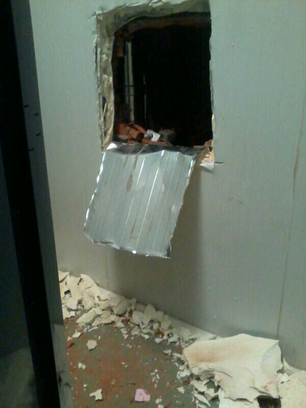

I relly never thought about this before but a big customer brought it up today. They had a break in through a wall that even had motion sensors installed; the motion sensors did not trigger an alert. They were even able to go past the PIR sensors (no idea how; but it seems they even got on camera how they did it). An audio sensor would have saved them from the break in, so now they are trying to improve their system with this.

I'm not that much on alarm systems, so I really have no clue on how to avoid a PIR detecting someone or how they did it to them. But it did happen. The guy probably knows way more than I do abaout alarms, we are mainly CCTV. But on their case, I am quite sure that an audio alarm would have worked, and it would have worked way in advance to any PIR, vibration sensor, etc., I doubt anyone can go through a wall without any sound being done, and the alert would trigger before they have been able to get inside.
What I am looking at preventing is something like this. Not exactly this, but you can get the idea (they didn't just use a hammer and made a hole, that would have triggered the vibration sensors).
I was told by an alarm guy that glassbreak sensors would work on tin siding destruction. Never tried to verify it though.
