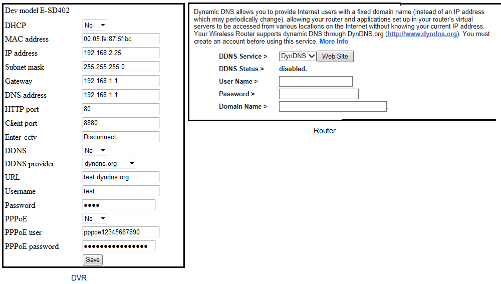

jackgreat 0 Posted April 17, 2013 Hi Guys, I recently installed CCTV cameras in my small office. I want to monitor them from the workplace and outside so I have configured the device and network setting. I managed to forward ports from my router. The following has been achieved : -I can see the cctv video from my local network in my pc and iphone. -I can also see the cctv video from outside my network through a web browser. The following I want to achieve : -I want to see the cctv video on my iphone when I am not in lan and that's not working out. I do not have a fixed ip so I registered with dyn-dns and my luckily my router supports it and after entering details, my router updates my ip address to that account. That's how I can see the video from outside the network in a browser. However when I try to view in my iphone using softwares like TMEye free which asks for ip,port,username and password then it works ok in LAN but not when I am outside lan. Why is this happening is something that is puzzling me ? I entered port 8880 in setting of tmeye app. The ports I have forward are 2 TCP ports 80 and 8880. I am attaching a screenshot of network info of my dvr. (Ignore the router part of image) Any help/guidance will be appreciated. Thanks, Jack Share this post Link to post Share on other sites
ron352 0 Posted April 21, 2013 First make sure the ports are opened at your office in the router by going to http://canyouseeme.org/ and type in the port you have forwarded. I know my DVRs have 3 to forward, 1 for web, 1 for media, 1 for mobile. If the ports are open and you have all ports required, I guess next would be to make sure you are using the right phone app software for viewing your dvr remotely. Share this post Link to post Share on other sites
