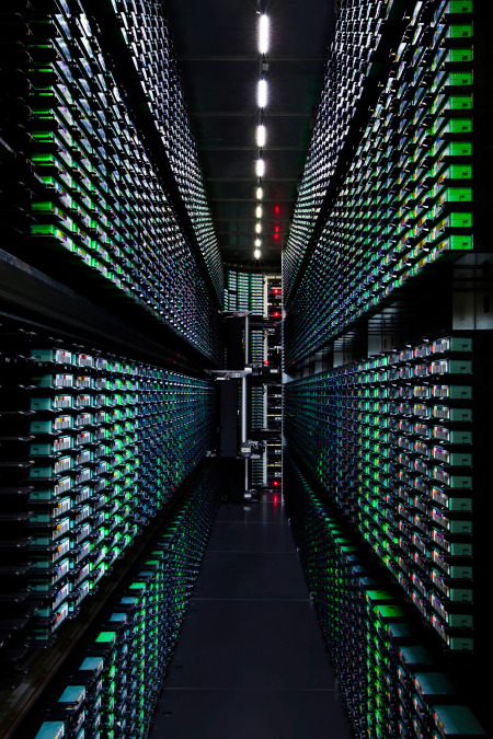

...PC HDDs are not made for 24/7 usage...
You had better call google and advise them that in your opinion their disk arrays are a VERY bad idea. I certain they will appreciate your expertise.
