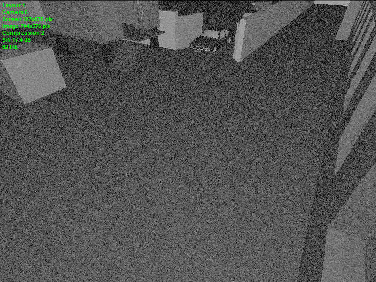

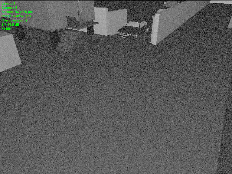

Stanislav 0 Posted May 6, 2013 Ive seen several posts where people have tried the 3.6mm with my camera, but has anyone tried the 2.8mm? Any shots available? Here is expected difference between f=2.8mm/F2.0 and f=.3.6mm/F1.8 in low light. When the light is sufficient there will be no difference in contrast and noise. f=2.8mm/F2.0 f=.3.6mm/F1.8 Share this post Link to post Share on other sites
