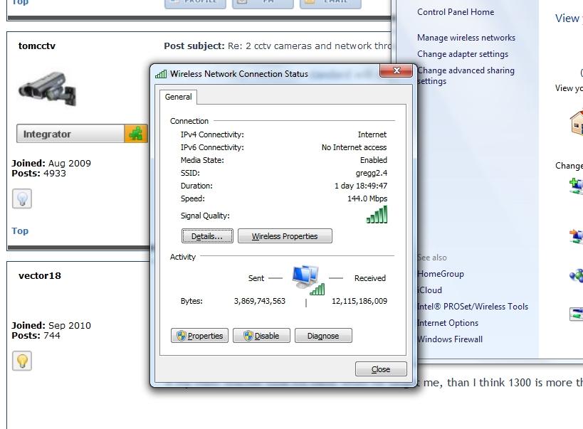

vector18 1 Posted May 5, 2013 Here is a screen shot of my current laptop using the internal wifi card. If I use my 5.0ghz usb adaptor, I usually get 450mbps, and I don'not need no stinkin cables connected to my laptop. So, I'm not sure why you wouldn't just said you can go with powerline or wifi, those are two options you can use because todays wifi technology has come a long way and you can achieve speeds that are acceptable by todays standards. But no, you just wanted to shoot me down, as you always do. Share this post Link to post Share on other sites
ak357 0 Posted May 5, 2013 Here is a screen shot of my current laptop using the internal wifi card. If I use my 5.0ghz usb adaptor, I usually get 450mbps, and I don'not need no stinkin cables connected to my laptop. So, I'm not sure why you wouldn't just said you can go with powerline or wifi, those are two options you can use because todays wifi technology has come a long way and you can achieve speeds that are acceptable by todays standards. But no, you just wanted to shoot me down, as you always do. Next time see if u can use other network tools and provide screenshot plz example DU Meter Share this post Link to post Share on other sites
