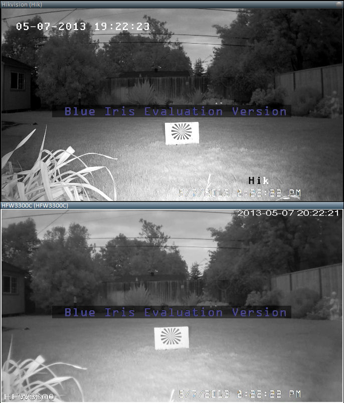

First, here's the overview shot - heading into dusk, but still a good bit of light out. The Dahua's a good bit brighter (which contributes to both night performance and its failure to switch to night mode in many situations), but the Hik is much more attractive. The Hik also doesn't suffer from the soft patches in the grass like the Dahua does, but shows some minor sharpening artifacts. Both the Hik and the Dahua will show the colors off into the purple end now and again.

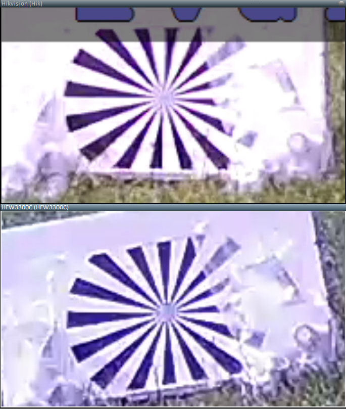

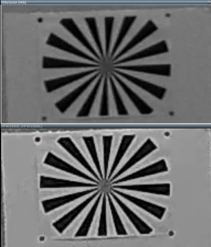

Here's a Siemens focus star, 10' away from the cameras, zoomed in all the way in BI. The Dahua has slightly better focus or resolution, but the Hik is on factory focus, as it's a pain to get into it. You can see from the brighter halos around the Dahua star that it's more over-processed, and it's a lot less dark.

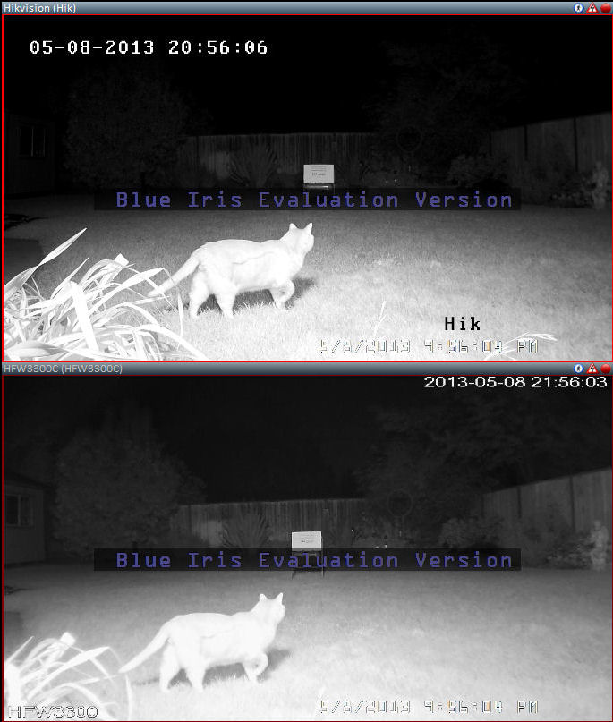

Switching to BW while there's still light out, but no IR on yet, shows that the Dahua lens has better IR correction. The star center focus is about the same on the Dahua as before, while the Hik loses some definition, though not much. The over-processing matters less in BW mode, and the Dahua's better night sensitivity makes the star brighter.

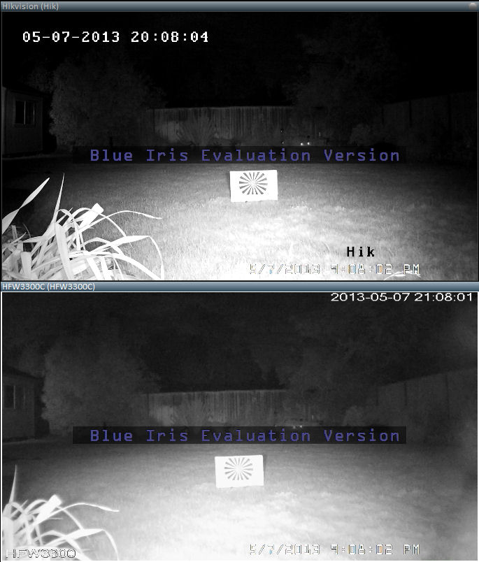

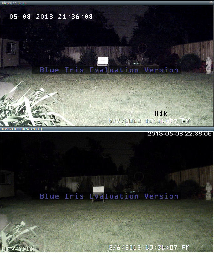

When it gets a little darker, the IR switches on on both cams, for this view. The Dahua's still brighter, but the Hik still looks better - crisper and cleaner.
Here's how the stars look zoomed in with the IR on. The Dahua's not looking so good against the Hik.

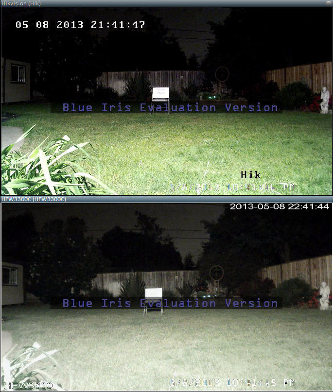

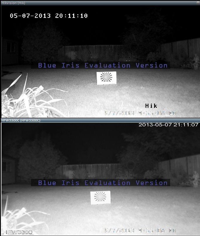

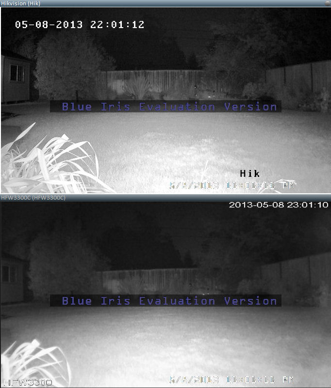

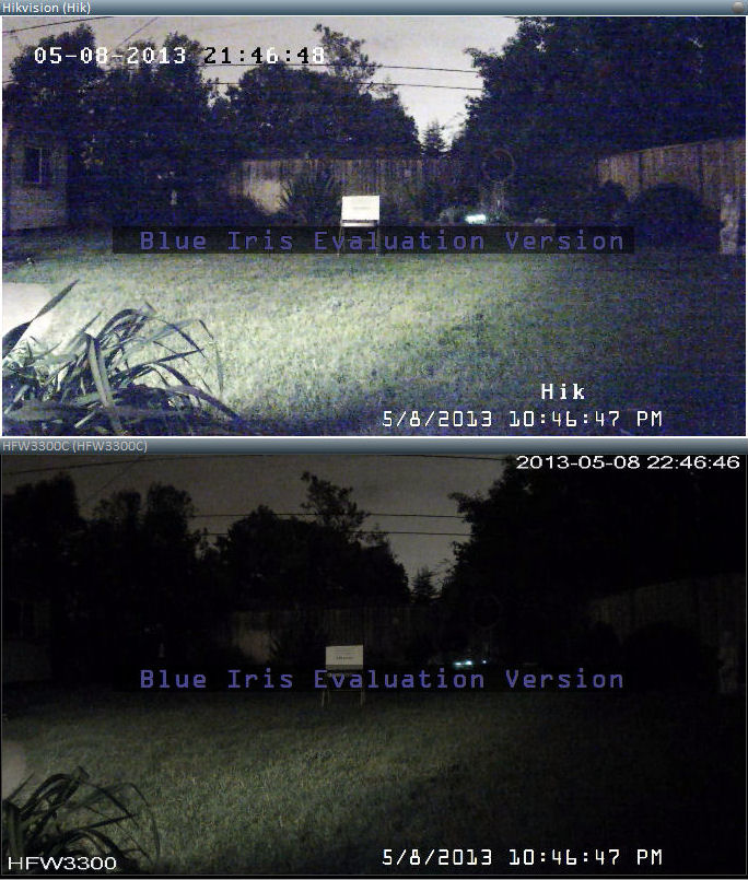

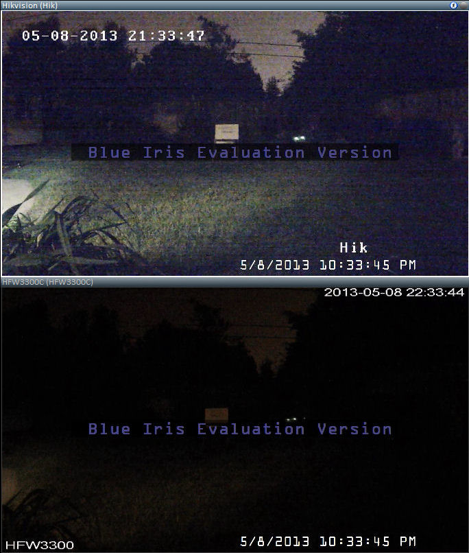

Now, it's pretty dark out. Again, the Dahua's got better sensitivity, and shows a lot more at the fringes - above the fence, and the IR splash on the building at the far right (from a Vivotek IP8332) is much brighter. However, the Dahua's a lot softer.

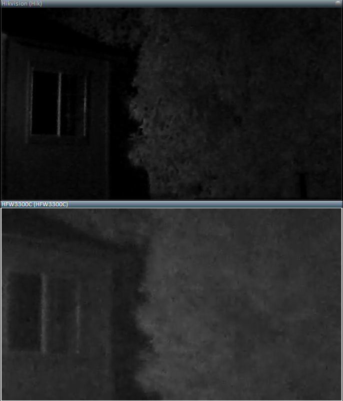

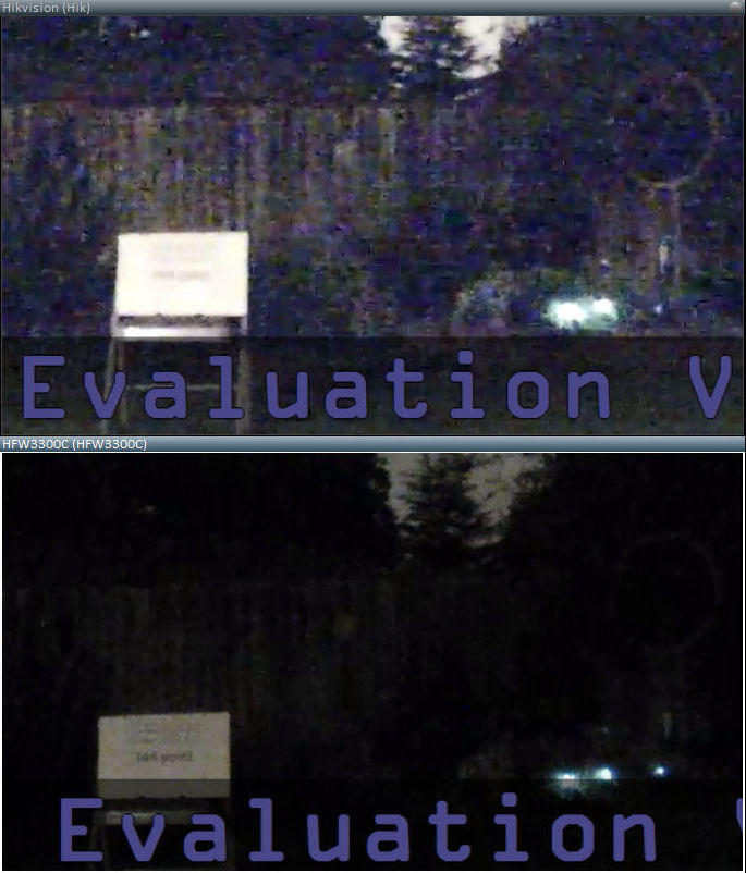

Here's a zoom on a darker area that shows the trade-off in night performance between the two pretty clearly. The Dahua's still brighter and shows more highlights, but is softer with sharpening artifacts from noise. The Hik is a lot sharper and more detailed. Which is better? It depends on your needs. The sharpening artifacts contribute a lot of apparent motion in the actual video.

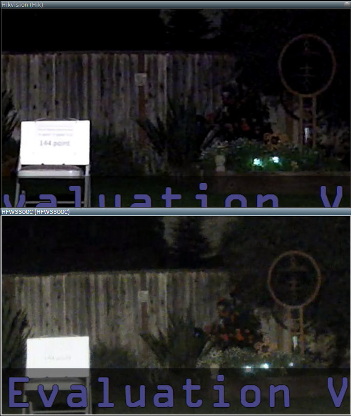

Here's the same shot with a pair of 150W halogen motion detector lights on. Again, the Dahua looks good from the big picture perspective, but the Hik is a lot sharper and more detailed.

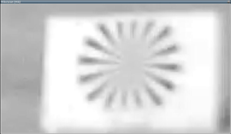

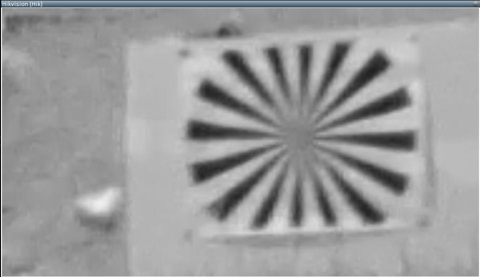

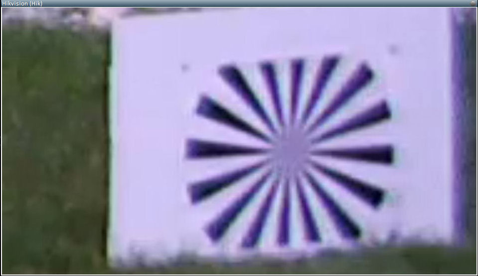

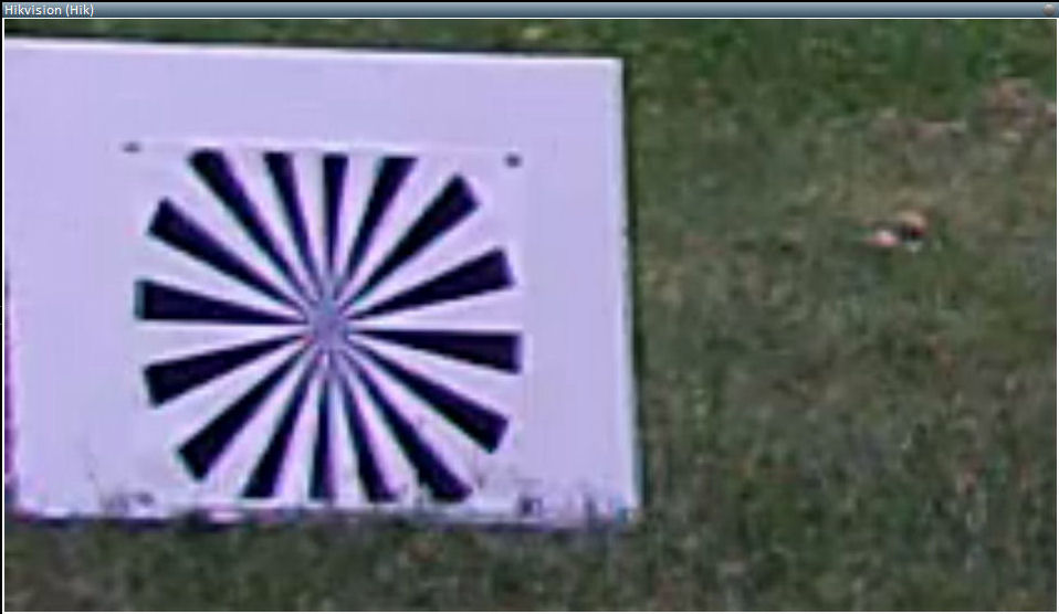

Now, there's also been some talk about the softness on the right side of the Hik, so I thought I'd grab a few shots of that as well. I did these over the weekend, and they helped me figure out how to get the shots I needed for the comparisons above.
Here's a focus star at the far left of the Hik field of view. I measured 10' out, then took the star to the edges of the field of view, so they're further than 10' at an angle. This is all in the daytime.
Same shot, but at the soft right edge - yuck! That looks like a lens element problem to me, but if that were the case, you'd expect different cams to show the problems in different areas, rather than all on the right side. Maybe the reason will be clear with more testing.
So, does the IR filter possibly have a problem along one edge? I switched it out, and tried again. Left side, not nearly as good as with the IR filter in.
Ugly right side with IR filter out - even worse!

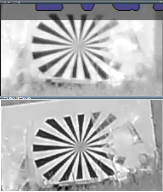

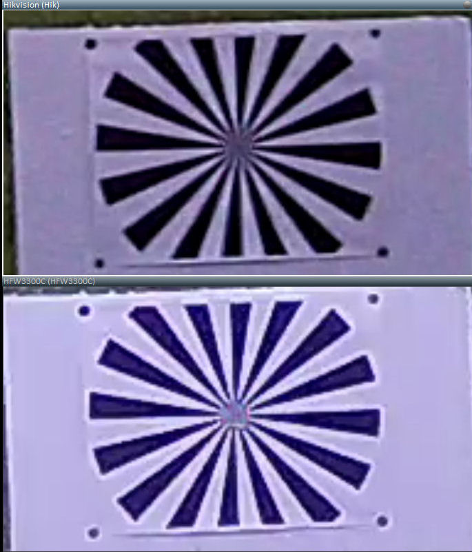

How does this compare to the Dahua? Here's a shot of both in color mode. It was windy that day, so I have some bags of PVC fittings holding the star onto the stand so it won't blow down.

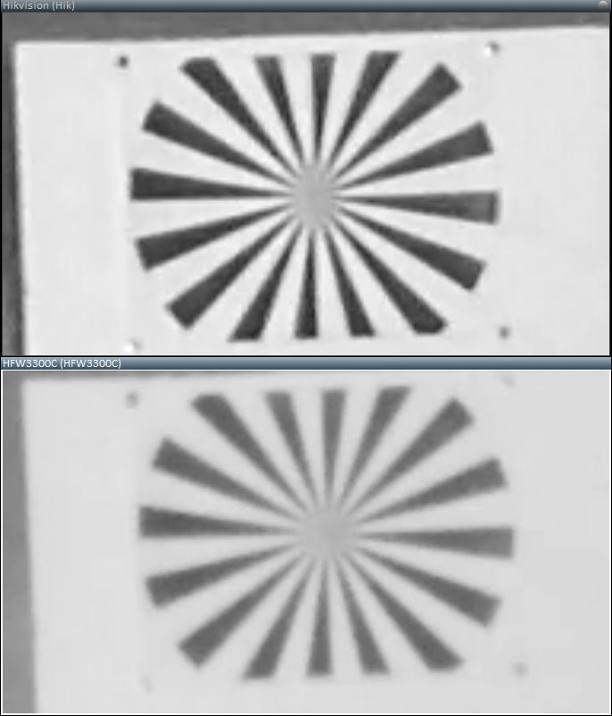

Switch to BW mode, and like the tests above, the Dahua's crisper and sharper in daylight, showing that the IR correction on the lens is better for the Dahua. It also demonstrates how the edges of a lens have worse resolution in general than the center, which is typical on inexpensive lenses.

Here's the Swann with WDR set at 50, following up on a suggestion by Buellwinkle to equalize the night exposure more - definitely an improvement in the shadows, and much better than the Dahua in sharpness.
The Dahua WDR really isn't very good, and seems to be more of a contrast adjustment. The more I test the Swann, the less I like the Dahua. I guess I'll try to sell it to someone who doesn't read these boards!
As seen in the following post, I think the better Dahua night performance at the fringes is due to exposure times, rather than sensitivity.

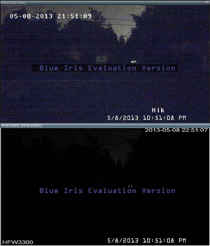

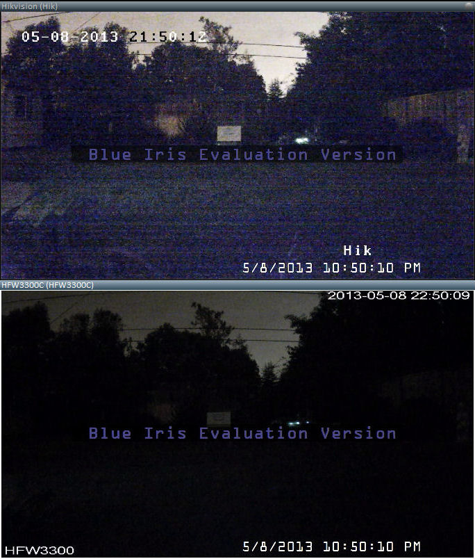

So, I started to get some night shots, and realized at the end that having the cameras so low was messing up the exposure, especially on the Hik, due to the bright IR on the ground in front of the cameras. I'll have to mount them up higher for meaningful results. I got some low-light color shots instead.
I now believe this is why the Dahua appears to have more sensitivity in the previous series - the Hik is speeding up the exposure above the minimum. The following shots show the Hik to be more sensitive overall.
Here's a good shot of the two cams in BW with IR on for both cams, so there's more than usual. The interesting part about this is the cat, who has a big shaved spot from a recent vet visit. The Hik shows a lot more detail here, as usual, which is pretty critical in night shots. The Dahua blurs the shaved border so it's almost unnoticeable.
