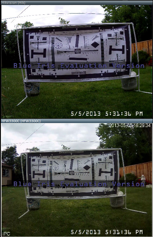

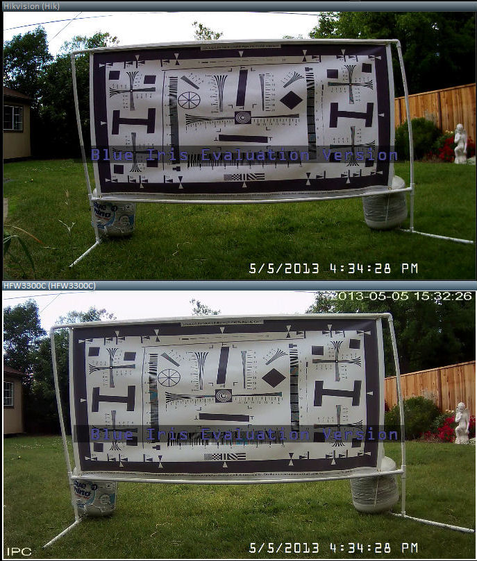

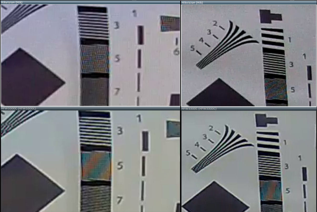

Here's the test setup. This is an ISO 12233 chart printed on a 6x3' banner, 6' away from the cams. Unfortunately, the printer was supposed to print it 4x3, scaled correctly with white space on one side for extra info, but they stretched it to fill the entire banner, and I didn't catch it until I had it for a while. So, it's not accurate for resolution testing, but is good for resolution comparisons. The frame is PVC, which I built many a structure from, large and small, back in my Burning Man years.
Hik is at the top, Dahua is at the bottom. It's very windy today, so it's held down by spare propane bottles. Both are set up for nearly identical field of view.
Here are the 3MP images, which show the problem - the two cameras clearly have a different field of view, even though they were matched at 1080p.

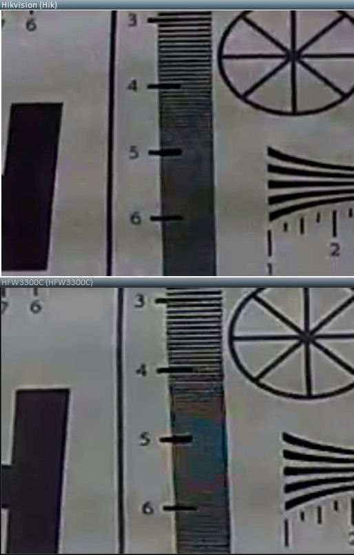

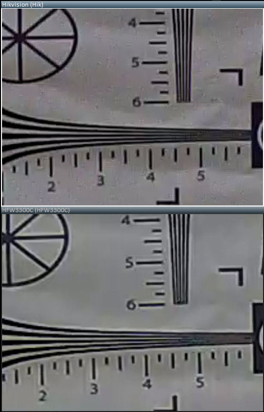

First step was to compare 1080p between the Dahua and Hik. Using BI, I zoomed in to the max on different parts of the chart that showed the edges of resolution, matched it between the cams, and took screenshots. You can see that the Dahua and the Hik have pretty similar resolution at 1080p, with the Dahua having a slight edge in places and the Hik in others. I believe the Dahua has a slightly better lens, but processing also affects the images - more on the lens in another post.
This is 3 different areas compared - again, Hik top, Dahua bottom:

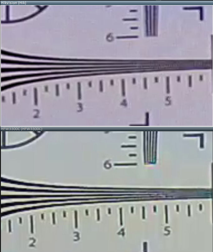

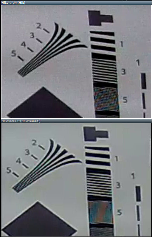

Next, I switched both to 3MP. As we saw above, the field of view is now different, which was the first clue that something was wrong with the Hik 3MP setting. To compare, I zoomed the Dahua all the way in, then zoomed the Hik so the view matched the Dahua.
You can see that the Hik now has different resolution than it had at 1080p, and than the Dahua. If it was switching to a true sensor 3MP resolution, the results would be the same as the Dahua and as the previous 1080p tests, since the difference between 3MP and 1080p isn't pixels per area, but more total pixels making the image larger.

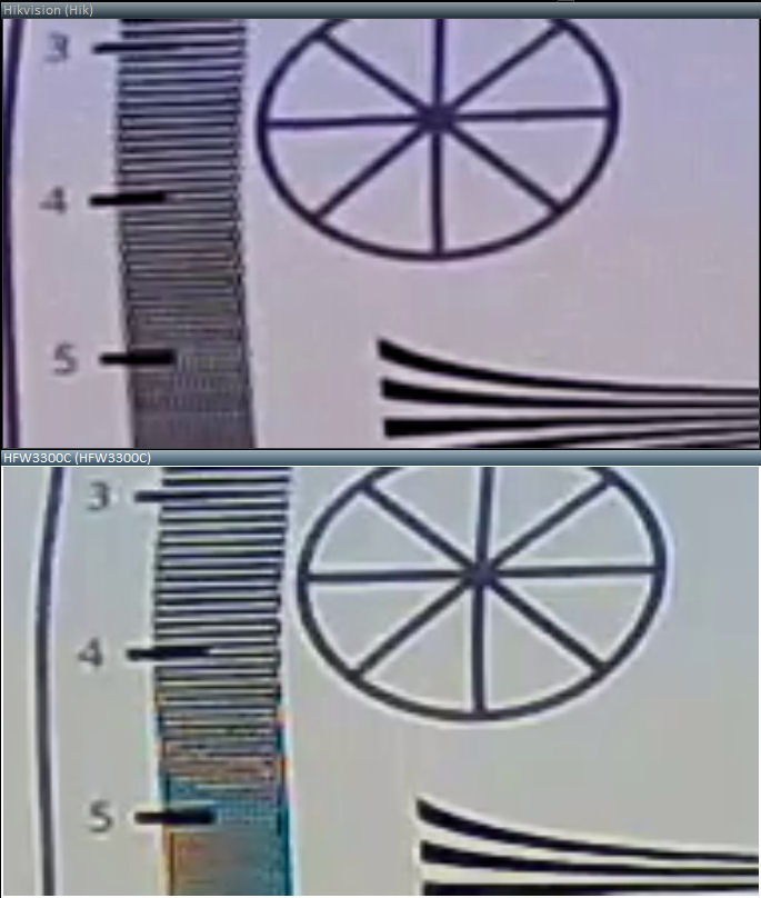

Same 3 areas, different zoom due to different BI view:
Finally, here are a couple of the shots side by side. The Dahua's resolution is the same on both, as it should be, regardless of the BI zoom factor, while the Hik has different resolution in 3MP than at 1080p. Presumably the Hik resolution change is due to the scaling algorithms, but again, it's hard to know what's happening inside.

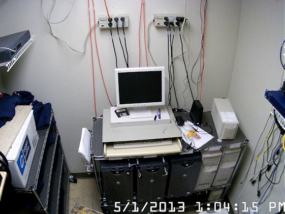

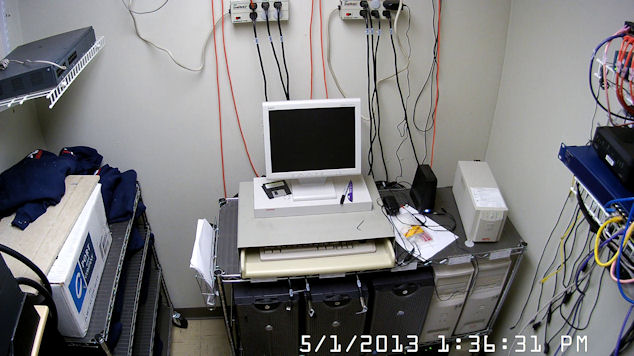

For starters, here are Q's original images that started me wondering about this. Since the 3MP image specs show more pixels in both axes, the 3MP should have more horizontal image showing, but it actually has less.
This says that the 3MP 2048 horizontal resolution is really less than the 1080p's 1920 pixels. The 3MP vertical 1536 resolution is larger than the 1080 resolution, so it is seeing more than 1080 pixels vertically.
Not only that, switching between both images shows the 3MP is zoomed larger than the 1080p, and if it was capturing actual sensor elements, everything common between the two images should be the exact same size, with more image around the edges of the 3MP image.
Here are these images, reduced by 1/3. The key is to see where each image stops compared to the other, as that's where the captured sensor pixels stop.

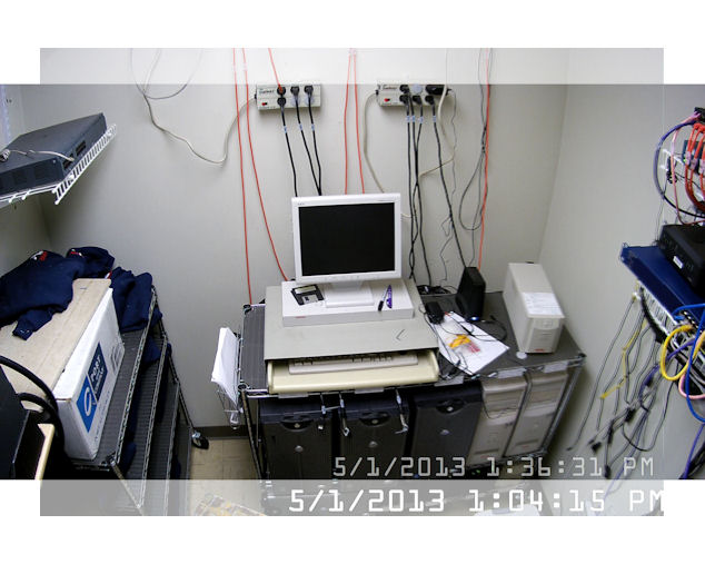

How to figure out what the real resolution is? Again, assuming the 1080p is correct, the easy way is to scale down the 3MP and overlay it on the 1080p until they match. This happens at about 83%, as seen below. If you scale down the horizontal and vertical pixel counts by 83%, you get this, which is what I posted in the original thread:
3MP actual = 1700x1275 (2.2 MP)
Here's the 83% reduced 3MP image overlaid on the 100% 1080p image.
We assume that the sensor maximum horizontal resolution is 1920, since that's the 1080p horizontal resolution, and we then assume the sensor maximum vertical resolution is the 1275 that the 3MP uses, because if they had more, they'd use it, you'd expect.
This gives us a sensor resolution of:
Hik sensor = 1920x1275 (2.5 MP) - note that this isn't 4:3 (SD) or 16:9 (HD), but is about 3:2.

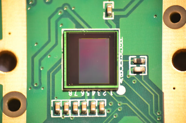

Now, it's very difficult to tell what's going on in the software, so the next step is to look at the actual sensor and see if it fits. Cam-it member Mark posted a huge pic of the sensor mounted to the board - here's a reduced version.
This is a very useful picture, as we can tell several things from it:
- The aspect ratio of the imaging section of the sensor chip
- The relative size of the chip compared to the SMD resistors, which come in standard sizes
First step is to determine how many pixels wide and tall it is. This is easy in an image editor; by selecting the imaging area, you just look at the pixel size of the selection. It turns out that the aspect ratio is about 1.5:1, or 3:2 - the same size as the estimate from the image scaling above. This is good, because it helps verify the initial estimate!
Next, the resistors are measured. It's hard to measure them accurately end to end, because of the solder, but most smaller SMD resistors are twice as long as they are wide, and the width is easy to measure. This gives us the length of a resistor in image pixels.
Since we know how many image pixels the sensor is, we can then calculate how many resistors tall and wide it is, and it happens to be about 5.1 resistors tall and 3.4 resistors wide.
SMD resistors come in various standard mm lengths, like 0.6mm, 1.0mm, 1.6mm, etc. If we convert the number of resistors to mm length, then convert that to inches, that gives us several possible sizes for the sensor's horizontal and vertical dimensions.
Since we know the diagonal is either 0.33" or 0.4" (and suspect 0.4" is correct), we can calculate the diagonal from X^2 + Y^2 = Z^2. Plugging in the various resistor standard lengths, a 1.6mm resistor gives us a sensor size of 0.39", which is plenty close enough to 0.4, given the sketchy measurements.
ETA: Due to the physical image size being roughly 2/3 the listed image size (see a few posts below), this isn't right. It's more likely these are 1mm resistors, and it just happened the 1.6mm size fit in the sensor size scaling. The other conclusions are still valid.
