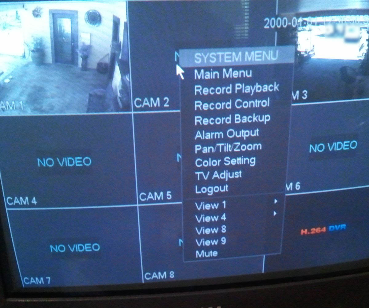

I have a dvr of unknown brand. When i placed a order for it about 2 years ago i put in hard drive , tested it to make sure it works.
Apparently any password it had that the manual stipulated worked at one time, but does not now. I dont know if I changed it and forgot it, but seems there should be some way to hard reset it manipulating the motherboard or something.
I went to set it up today and no password works.

the interface is this when hitting menu or right clicking.
the manual says the password should be 88888888 and this does not work.
I have no contact number in the book, or anything , seems like some generic dvr manual for 4/8/16 and says H.264 and thats it.
I have tried all the typical 123456 , 111111, 888888 and im litterally sitting here just going thru numbers trying to guess it, but is there anyway by lettering on motherboard to figure out what might be a master password?

When you click "Main Menu" does it display a Username and Password prompt? If so, is there a default username already in the field? The password can sometimes be the same as the username.
