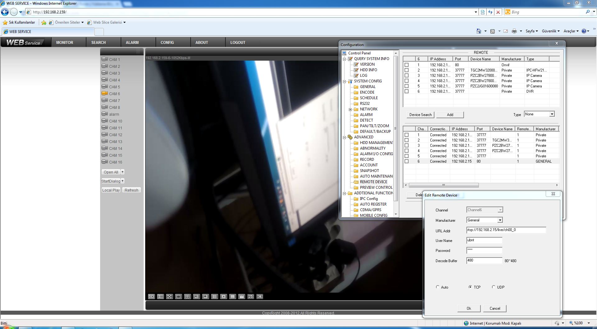

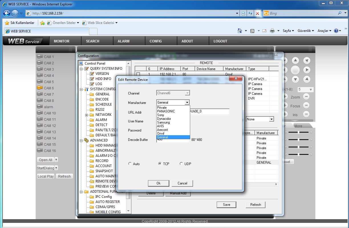

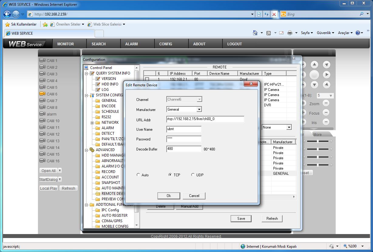

teknologs 0 Posted May 19, 2013 Dahua nvr new firmware now rtsp view... going all the cameras that support rtsp... I tested it with the brand rtsp ip camera with Ubiquiti aircam... new firmware now download... ftp://194.197.92.197/drivers/dahua/NVR-sw/General_NVR3xxx_Eng_P_V2.610.0000.3.R.20130119.zip Share this post Link to post Share on other sites

Elon 0 Posted May 23, 2013 Hi, I've flashed on my 3204 (NOT P) model and it has worked like a charm. I've found the URL I need to use from the camera web interface using chrome developer tools (F12) and checking the SRC for the quicktime player. Anyway, it's worked really well and was worth the risk. Thanks everyone! Share this post Link to post Share on other sites
