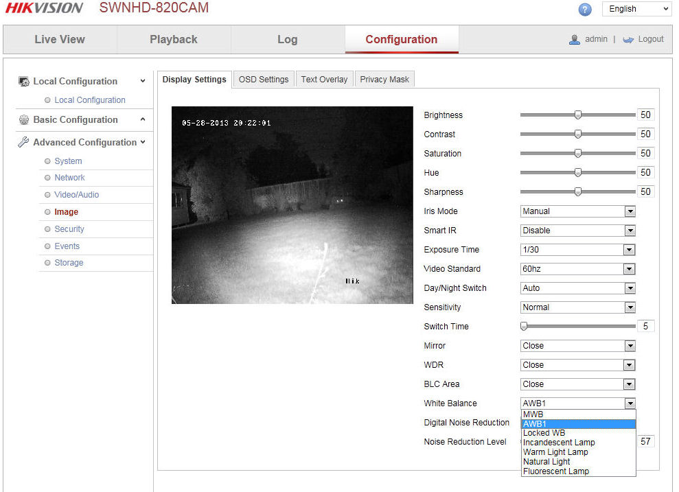

MaxIcon 0 Posted May 29, 2013 So, I posted about bugs in the 5.0.0 firmware that caused the 3MP setting to not work right, but turns out I didn't have the latest webcomponents.exe loaded. I'm not sure why it didn't prompt me to install the latest version after flashing, but when I re-connected the camera after a few days offline, it did. Now, the 3MP works fine (so far), and there are new features that weren't showing up before, like Intelligent IR, more white balance selections, more network option tabs, and so on. I can't tell what the intelligent IR does, though. When enabled, there's no obvious difference, and with another camera watching the IR footprint, I can see no changes in IR when I get right in front of the camera. It sounds like the cameras are shipping with 5.0.0 now, and that's a good sign. It only allows you to set 15 fps at 3MP, like the spec says. Share this post Link to post Share on other sites
spadjen 0 Posted May 30, 2013 So, I posted about bugs in the 5.0.0 firmware that caused the 3MP setting to not work right, but turns out I didn't have the latest webcomponents.exe loaded. I'm not sure why it didn't prompt me to install the latest version after flashing, but when I re-connected the camera after a few days offline, it did. Now, the 3MP works fine (so far), and there are new features that weren't showing up before, like Intelligent IR, more white balance selections, more network option tabs, and so on. I can't tell what the intelligent IR does, though. When enabled, there's no obvious difference, and with another camera watching the IR footprint, I can see no changes in IR when I get right in front of the camera. It sounds like the cameras are shipping with 5.0.0 now, and that's a good sign. It only allows you to set 15 fps at 3MP, like the spec says. do you know what happened to White Balance in this version? used to have auto and 1 other setting. now all it has is manual. Share this post Link to post Share on other sites
MaxIcon 0 Posted May 30, 2013 Well, that's one of the funny things. The first time I checked it, that's what I had - auto and manual, and manual enabled 2 color sliders (the 3rd color can't be changed). After re-installed webcomponents.exe, I now have a big selection of presets under white balance. Before, I don't think I rebooted both the PC and the camera at the same time. When I connected the other night, both had been off for a few days, and it asked me to re-install webcomponents.exe. Try that; if it doesn't work, I'll post the new webcomponents and you can see if that helps. Share this post Link to post Share on other sites
spadjen 0 Posted May 30, 2013 I will try that tonight. got the file directly from hik ftp. wonder if i have the correct version/ release. i dont see much difference at all in settings. no white balance at all. no intelligent ir. can you grab a screen shot? i did notice the 15 fps limitation. also...something weird. blue iris would have difficulty at anything above a 4096 bitrate. would freeze up, disconnect from the cam, and have data corruption. now i can go upto 16384 no problem. Share this post Link to post Share on other sites
MaxIcon 0 Posted May 31, 2013 This came from the US FTP site on 5/10. I just downloaded it again and compared it to the original, and there are no binary differences between the files, so it had something to do with the reboots. Another option would be to delete the existing web components folder, which is under Program Files on mine, then connect. It should install the latest version. Here's the version reported by the camera: Firmware Version - V5.0.0 130412 Encoding Version - V4.0 build 130411 The webcomponents.exe version is 3.0.4.6, while the old one from version 4.0.9 was 3.0.3.18. and the image setup screen, with both the new WB settings and the Intelligent IR setting. My Blue Iris had trouble with high bit rate images from both the Hik and the Dahua 3MP bullet, and a recent update that included a smoothness fix (don't remember which version, but after direct to disk was added) got rid of that. I still see the occasional frame rate drop, but before that, it couldn't go above 4096 on either cam with a well lit scene with lots of detail. I'd get hundreds of dropouts in a sunny yard between 6 am and 6 pm, and none after the sun went down. Share this post Link to post Share on other sites
