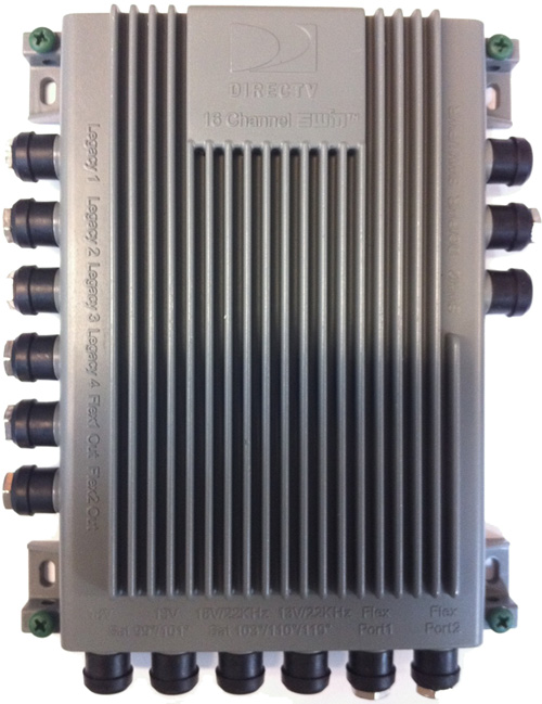

With the amount of trail and error you may end up having to do you might find it easier to just start fishing a new cable and be done with it. Like I said before no scenario is going allow them to use the satellite receiver to view your modulator, so it may as well be on its own line. If they have Directv most liikely there is a SWM16 in the attic:
This should feed into what may look like conventional TV splitters, this is where you would inject the modulator. You would basically put x2 2way splitters onto a line which without a meter I can tell you will knock the signal down by 7db. Depending on the given system you may have enough margin for that not to matter, if it is too much then an amp would be needed and this is where it could get too messy without the RF experience.
This might be best to quit while you are ahead but you know this customer better than I. The last thing you might want to hear is "ever since you did that work in the attic...."
