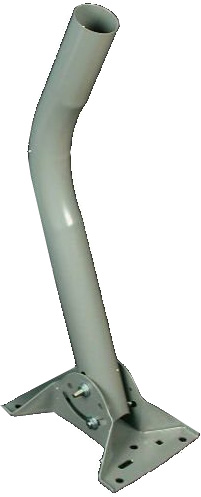

The antenna mounts are Moen Stainless Steel 18" grab bars; cheap, strong and permanent.

Satellite dish arms look better, more adjustable and don't look like they belong in your bathroom.
Certainly an option for some applications. I chose the Moen 18" Stainless Steel bars because they will never rust, can't be bumped out of alignment, came with SS hardware and only cost $20 incl shipping. I also thought they made a clean appearing installation. 12" would work as well and might be even cheaper. Neither would work on an angled mount like a roof but I only have wall mount locations.
So how about if I told you they were Industrial antenna mounts, built to commercial standards to withstand F5 tornadoes and Cat5 hurricanes and winds in excess of 300mph, made of solid Stainless Steel, will never rust, corrode or need paint, will last forever and come with a lifetime guarantee, and I paid $200 apiece for them? Still look like a bathroom?
