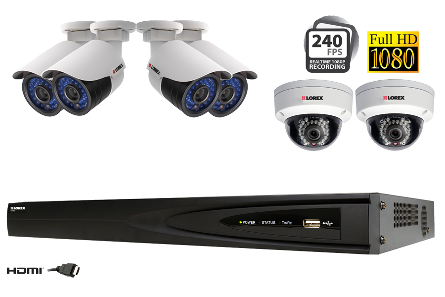

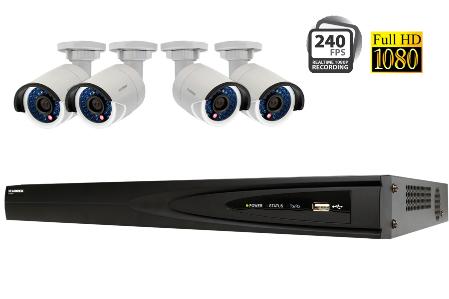

For those that purchased the Lorex NVR from Costco, is this the same system you got?
Lorex 8 Channel Full HD Real-Time PoE NVR Security System with 2TB Hard Drive and 6 1080p IP Cameras
http://www.costco.com/Lorex-8-Channel-Full-HD-Real-Time-PoE-NVR-Security-System-with-2TB-Hard-Drive-and-6-1080p-IP-Cameras.product.100048586.html
It just appeared in their online store in the last day or two (7/17/2013). I just ordered the Swann NVR with 4 cams, but the Lorex package seems like a better deal for $100 more since it's got 4 bullets + 2 domes (which apparently are 3MP domes) -- from the research I've done here, I believe these 2 Swann and Lorex systems sold at Costco are both just rebranded Hikvision products, but not sure if the Lorex comes with the DS-2CD2032 bullets like the Swann apparently does?
The cameras from the stock photo on that Costco page don't appear to be the Hikvision DS-2CD2032 (at least the outer shell isn't the same), but if you look at the product on Lorex's site and their spec sheets, other variations of that NVR + cam bundle has what appear to be (externally) Hikvision DS-2CD2032 cams.
On the costco page (listed as model LNR282C6B at the bottom):
On the lorex website for LNR282C6B:
On the lorex website LNR282C4B, which seems to be the same NVR bundle that comes with no domes and 4 bullets that (externally) look like the DS-2CD2032:
Does anyone know who makes the bullets in the Costco Lorex system, which don't externally look like the Hikvision DS-2CD2032? The mount looks similar, so maybe they are Hikvision DS-2CD2032 bullets, but I don't see a similarly shaped bullet on their website. Could they just be in a slightly different body but with the same internals?
thanks
Edited by Guest
That Lorex system looks like a really good system.
I have the same system just with the 4 bullets and then bought 2 of the domes extra.
Orig bullets - http://www.lorextechnology.com/downloads/ip-cameras/LNB2151/LNB2151_TRIFOLDQSG_EN_R1.pdf
Those bullets look different, with the black section of the housing.
New bullets - http://www.lorextechnology.com/downloads/ip-cameras/LNB2153/LNB2153_TRIFOLDQSG_EN_R1.pdf
If the specs are the be believed, the min illumination was improved upon in some of the descriptions, not in the pdf though.
The spec sheet shows how to connect via a POE switch, and the mention of a 12 VDC power supply, only differences I see.
