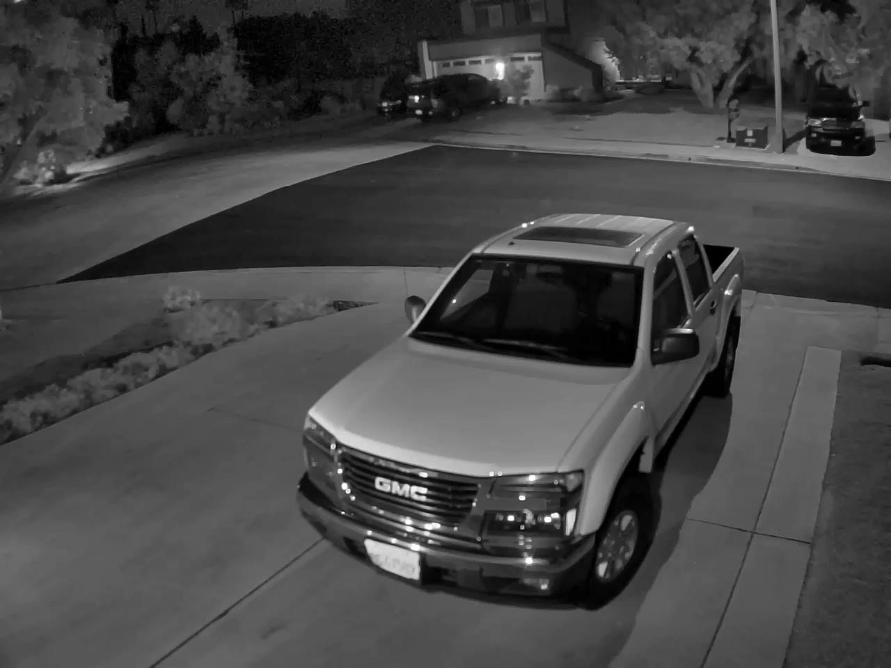

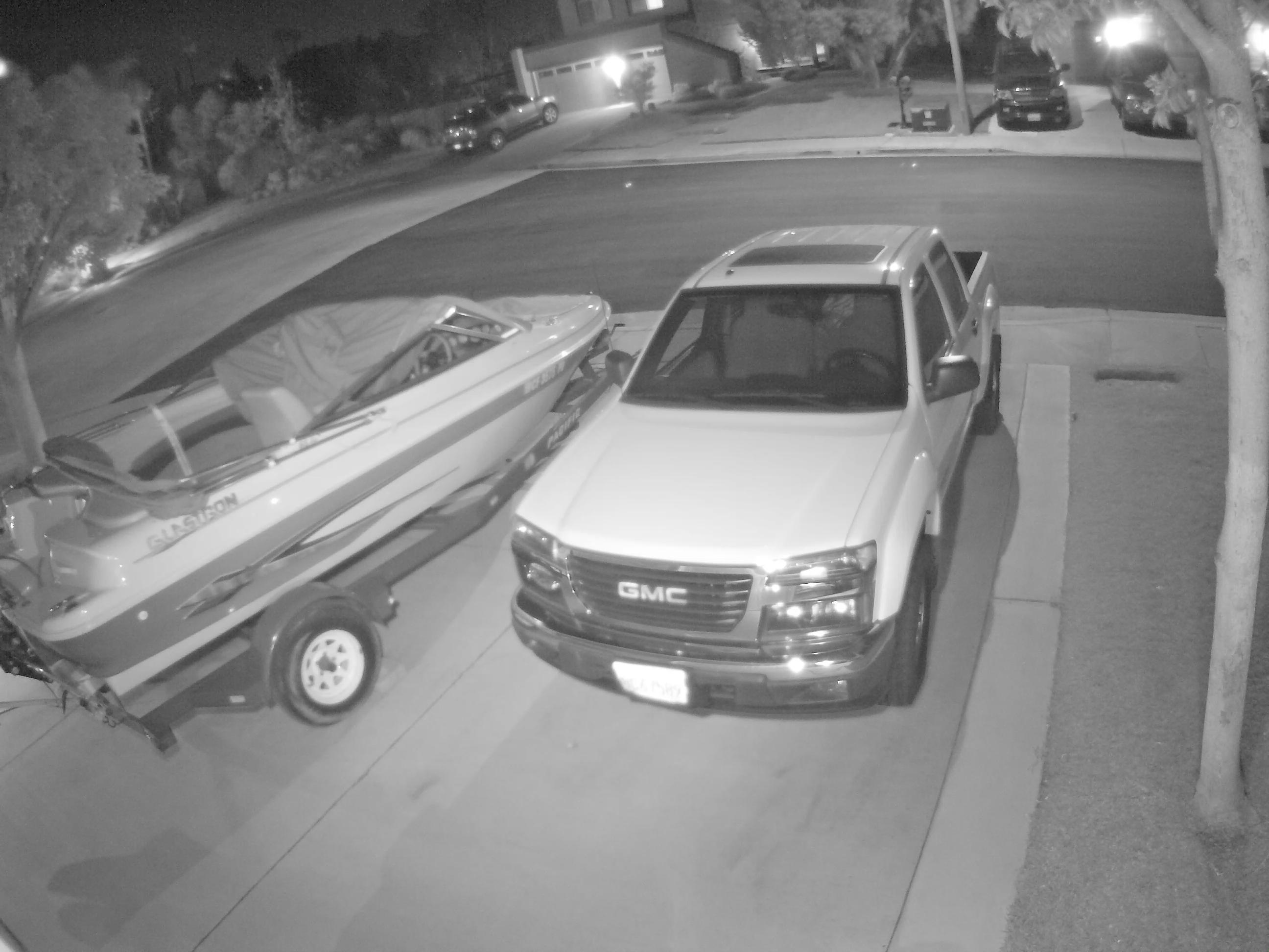

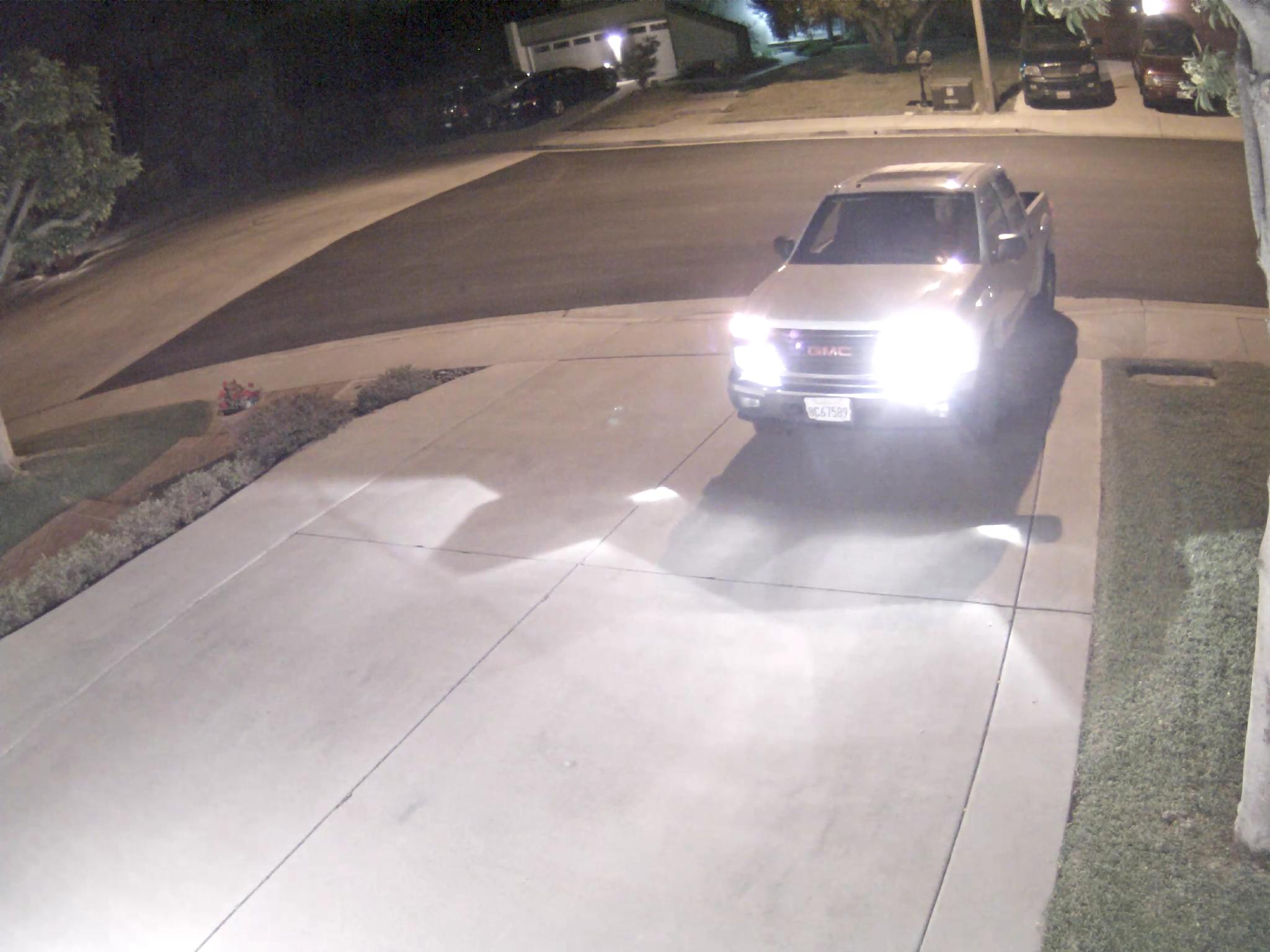

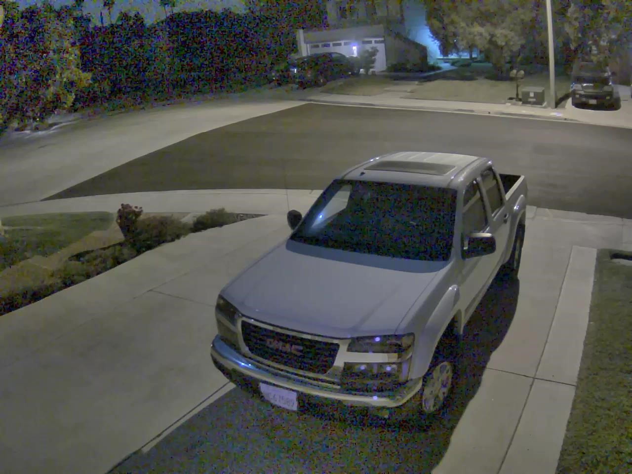

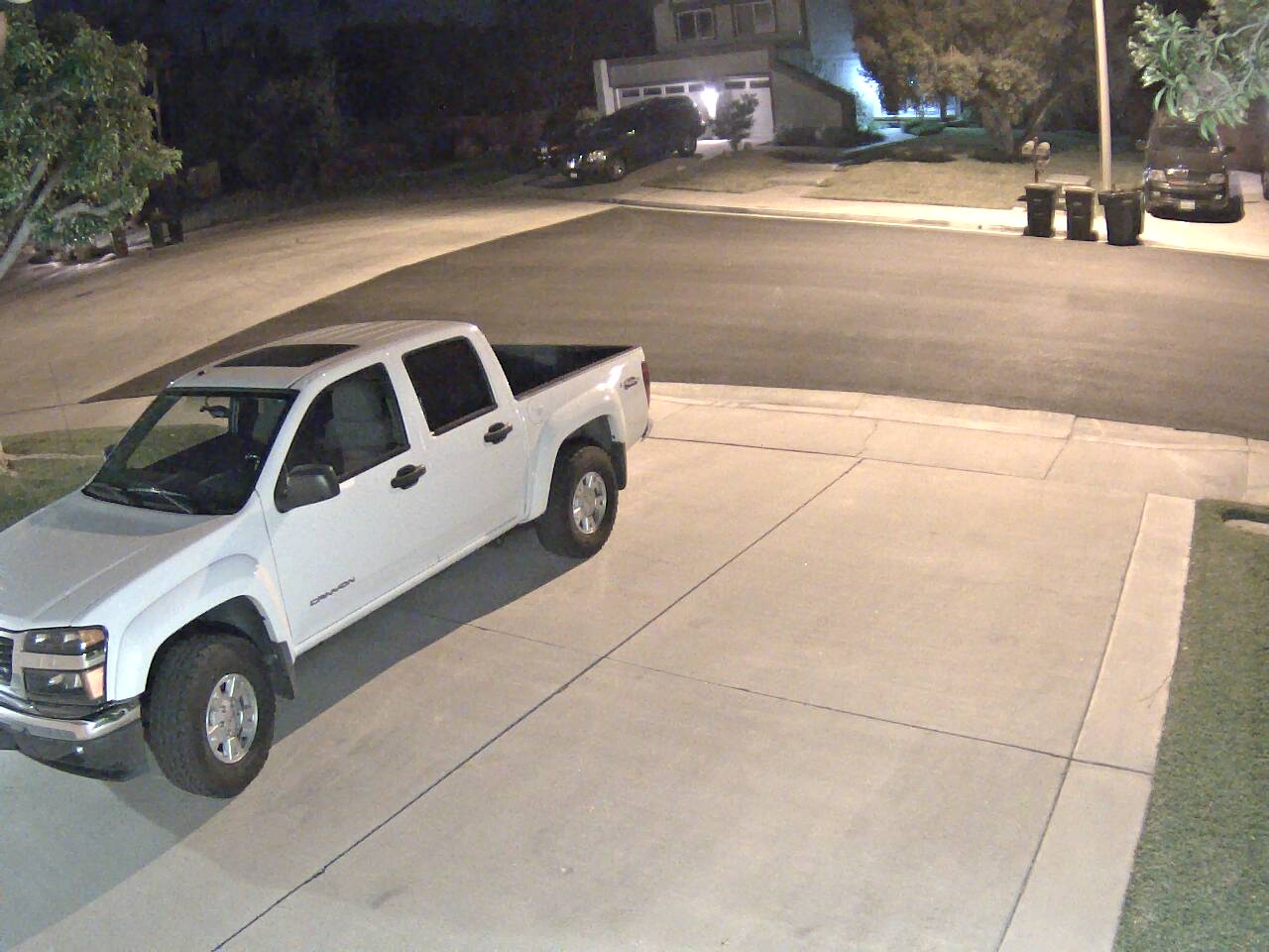

buellwinkle 0 Posted June 5, 2013 Actually, the P3384 is either WDR or Lightfinder, not both at the same time, the P3367 is WDR and has good low light sensitivity, actually better than the P3384 in WDR mode. I'm not pushing 5MP as much as telling you which is the better camera overall and the 5MP is a bonus. Did you see my review? Here's snapshots from it. P3367-VE at night, color mode, no IR at all. You can see with WDR it's managing the headlight and you can even read the plate. this is B&W mode with IR This is the P3384-VE at night, color mode, WDR (no lightfinder) on This is the P3384-VE at night, color Lightfinder (no WDR) on This is the P3384-VE in BW mode Share this post Link to post Share on other sites

TommyB 0 Posted June 5, 2013 buellwinkle said: Actually, the P3384 is either WDR or Lightfinder, not both at the same time, the P3367 is WDR and has good low light sensitivity, actually better than the P3384 in WDR mode. I'm not pushing 5MP as much as telling you which is the better camera overall and the 5MP is a bonus. Did you see my review? Here's snapshots from it. P3367-VE at night, color mode, no IR at all. You can see with WDR it's managing the headlight and you can even read the plate. Yes, reading it and just finished the 3384 review. Some times I just hate choices Never know if your making the right one. But hey, that's why you guys are here. Help guide me to make the right choice and if I drop 15k-20k on video, I don't have to take the heat for it when wife asks.. I'll just blame all of you! Share this post Link to post Share on other sites

buellwinkle 0 Posted June 6, 2013 You'll find use for all 3 as not every location requires 5MP. Sure, the P3364/P3384 with Lightfinder is better in low light, but it's not a huge difference to me and I think the WDR works better. Share this post Link to post Share on other sites
