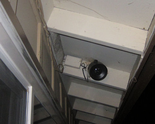

I like to put mine in junction boxes, though my Dahua 2100 is under the eaves and the connectors are just hanging there. As soon as I get the time, I'll put a box up.

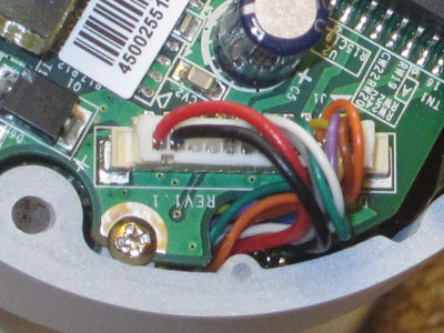

Max, when you pulled the SWNHD-820CAM apart, did you see if it was possible to "unplug" the two-lead pigtail that comes with the camera and plug in (substitute) a Cat5 cable with a RJ45 connector?

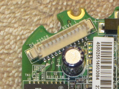

No, it's got an inline header, like most cameras these days, especially the compact ones. You could make a new connection to replace it if someone figured out what type of connector it is. I'll post some pics up later.

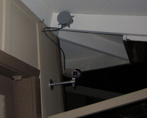

I'd like to see a couple of pics of your "box" mounts - to give me some ideas for improvements. Two of my cams are mounted way high up under the eaves, so definitly way out of reach. But, some of the others are within reach if you're quite tall, or happen to bring a small ladder with you

Here are the headers on the Hik/Swann. On the one with the wires attached, the red and black are to the DC power jack, and the rest are to the network cable. Yeah, it would be a pain to make a longer adapter for this.
Here are a couple of boxes without conduit, because the conduit I had was too stiff. I since got some more flexible conduit, but haven't gotten around to taking it all apart. The Y-cam was my first IP cam, and started this whole transition from analog to network cams.
Y-cam mount watching the front door, with both DC and network cables. A bird built a nest on it last year, so there's a bit of staining, but no problems from any of that.
