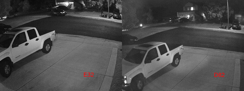

OK, be lost no more. Do not go by the lens focal length or aperture. I can tell you that side by side, the E32 with F1.8 4.2mm lens has better low light capability, and about the same horizontal viewing angle at the D82 F1.4 varifocal lens set at it's widest setting, 2.8mm. I didn't believe it at first so I re-adjusted the lens on the D82 and that's as wide as it gets.
Theoretically, same 3MP sensor. I have them side by side, so looking at the same view you can judge the viewing angle. Weird huh?

Man that e32 really performs at night after looking at the picture on the phone. I gotta find a dome that has that kinda quality at night for about the same price. I want to move from bullets to domes. The e82 looks soft. Is that ir bouncing off the dome, softness in general, lens, wdr....why is it so much softer.
The softness is noise reduction working overtime. But before you pass total judgment, I installed the latest firmware upgrade which is new on all the cameras and we'll see tonight if it makes a difference.
