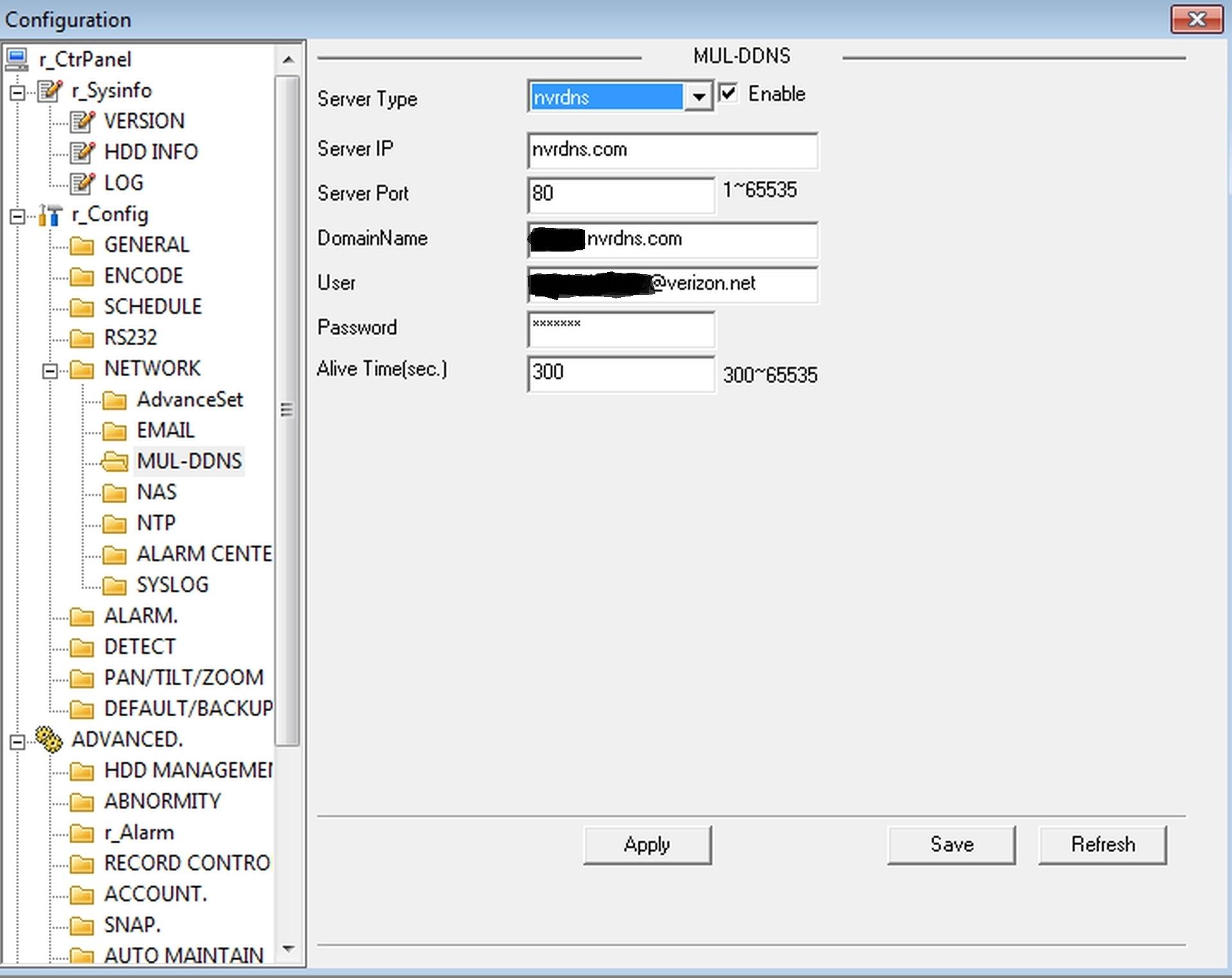

vector18 1 Posted June 12, 2013 You shouldn't have to change anything in your router. Go to the settings in the DVR and under network you will see ddns. Find where they entered dvrdydns info and change it to your no-ip info. Share this post Link to post Share on other sites
mkstretch 0 Posted June 12, 2013 Yeah it has the no ip option but it also asks me to put in info for server info under ddns settings. On the no ip site I picked the dns host a setting but it also asks for IP address. When I get home I will take a screen shot of the settings it's asking for. Thanks Share this post Link to post Share on other sites

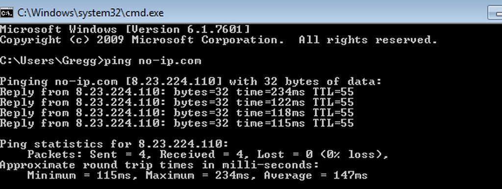

vector18 1 Posted June 12, 2013 For the server IP, you can either enter no-ip.com or, you ping no-ip, you will see the actual IP of no-ip. Share this post Link to post Share on other sites

vector18 1 Posted June 13, 2013 do not use www in front of no-ip.com, use port 80, that is what your DVR uses to send info to no-ip, device alias is your domain name in full, for example, mkstretch.no-ip.com, user name and password is the user name and password to log into no-ip Share this post Link to post Share on other sites
mkstretch 0 Posted June 13, 2013 My http Port on my dvr is 8081 not 80. Also what about the settings on the no ip site. It also asks for an IP address. Thanks Share this post Link to post Share on other sites
vector18 1 Posted June 13, 2013 The port in the ddns setting is what the dvr uses to send info OUT on. The port in your network settings is what port you use to view your dvr from the outside world. In no-IP, enter the IP of your modem. Share this post Link to post Share on other sites
mkstretch 0 Posted June 13, 2013 Ok so the http port under network setting port under ddns don't have to be the same? In no ip I just use my router ip? Share this post Link to post Share on other sites

mkstretch 0 Posted June 13, 2013 I put the settings in place and still cannont get into my dvr for remote viewing. Under DDNS settings on my DVR I put port 80. I port forwarded my TCP port and my HTTP from my DVR's network settings. I put my router ip I use to log into my router from home into no ip website settings. I dont know what Im missing. Share this post Link to post Share on other sites
mkstretch 0 Posted June 13, 2013 remote login is working now. But I had to change my host Type from DNS Host A to port 80 Redirect, and i went to whatsmyip.com website and used that ip for my computer on the no ip website instead of the usual router ip. Share this post Link to post Share on other sites
vector18 1 Posted June 13, 2013 Yes, when I said modems IP, I meant your outside IP, not your internal. I wasn't specific cause you had mentioned you had computer knowledge. But either way, glad you got it working. Share this post Link to post Share on other sites
