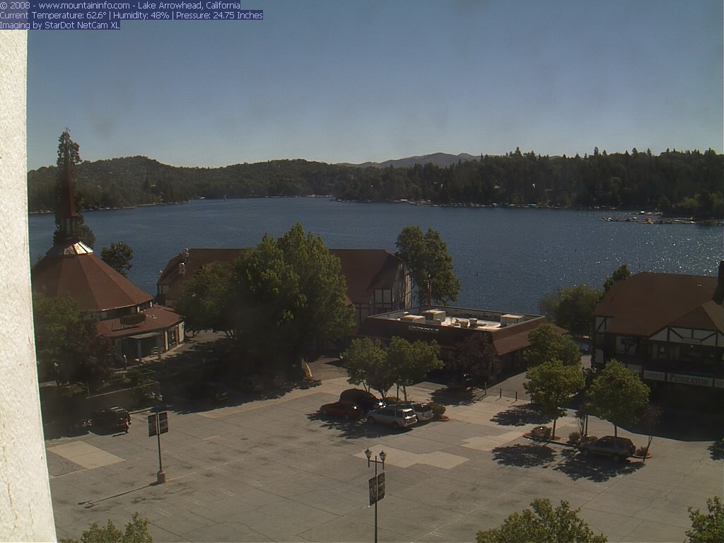

buellwinkle 0 Posted June 19, 2013 Maybe overkill to have a 1080P camera on a website for weather. Were you planning on having live streaming video or still images updated on a regular basis. Were you going to integrate weather data into the camera display or keep it separate. For example, if the weather data is separate, having more than even VGA resolution may take up too much screen real estate, maybe 800x600 at most with weather data integrated in the display. The reason I ask is why put money into a 1080P camera when the money may better go towards a more reliable camera. Also, how important is low light capability because the Dahua with the illuminators works well if your subject is say 30-40' away, but a panoramic mountain view would not benefit from this at all. Also, what's weather like? Because maybe a box camera in a housing with a heater/fan/wiper may make more sense. BTW, here's a Stardot webcam near me. I really don't like the image quality but it could be how the camera was setup. Here's another on the same lake, a very old Mobotix camera - http://www.golakearrowhead.com/webcams/view Share this post Link to post Share on other sites
