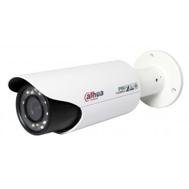

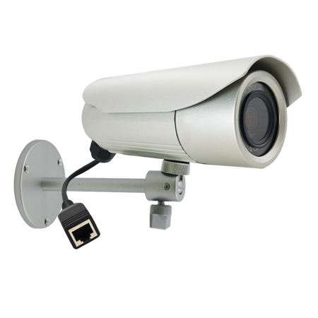

grege 0 Posted July 9, 2013 Sounds good. I was looking at WrightwoodSurveillance.com and comparing the ACTi cameras mounting to the Dahua cameras mounting. The ACTi has more of the mount I am familiar with where I could mount it on the side of a house and point it in any direction. Is that possible with the Dahua? The mount comes out of the back of the camera so it's hard to see how you can adjust it. I do like on the ACTi how you can replace their pigtail with a Ethernet cable and run it thru a flexible conduit to a weatherproof enclosure or right inside your house. How does ACTi compare to Dahua? I'll do some searching on that too. Share this post Link to post Share on other sites
buellwinkle 0 Posted July 9, 2013 Not going to kid you, the Dahua is a PITA to mount. You'll need to make a hole about 1" square to fit the connectors through and screwing it in while holding a heavy camera is also fun. But the look is very clean, no wires showing, so a trade off. ACTi has cameras similar to the Dahua in style like the E44 and I'm not crazy about that either although slightly easier to install as you mount a ring to the wall or eave and then attach the camera to the ring via a collar. Also, ACTi has an alternative mount for the E32 for example that is thicker and has a path for the wire to go through, the PMAX-1103. Share this post Link to post Share on other sites
grege 0 Posted July 9, 2013 So with that Dahua mount, could you put in on the side of a house and have the camera 90 degrees to the base? Does that make sense? That ACTi mount you can spin the camera in any direction just wondered if you can do that with the Dahua mount. Share this post Link to post Share on other sites
buellwinkle 0 Posted July 9, 2013 Yes, I have one mounted on the side of my house looking down the side so it's almost parallel to the wall. They rotate in 3 axis, so you can move the camera up/down, side to side and rotate it. You then tighten allen screws to hold it in place. Share this post Link to post Share on other sites
grege 0 Posted July 9, 2013 Good to know. It's really hard to tell that from the pictures I see on the internet. Share this post Link to post Share on other sites
grege 0 Posted July 9, 2013 Buell, I think I am leaning towards the ACTi cameras. Mainly because of the mounting and the way the cable comes out with the flexible conduit. I already have a weatherproof box mounted on my garage and thinking about the other mounting places I plan on using I think that would work out better for me. Going with that plan, which ACTi bullet camera should I look at? I was thinking D42 because it is 3M and has the vari-focal lens but then I saw the E42 that added WDR and didn't know if that would be good to have. Also, I saw on one of your reviews where you said that with all ACTi cameras you are entitled to use their software. I already have Blue Iris so would you recommend Blue Iris, the ACTi software, or buying an ACTi NVR to record video and send out emails? Thanks for your help!!! Share this post Link to post Share on other sites
