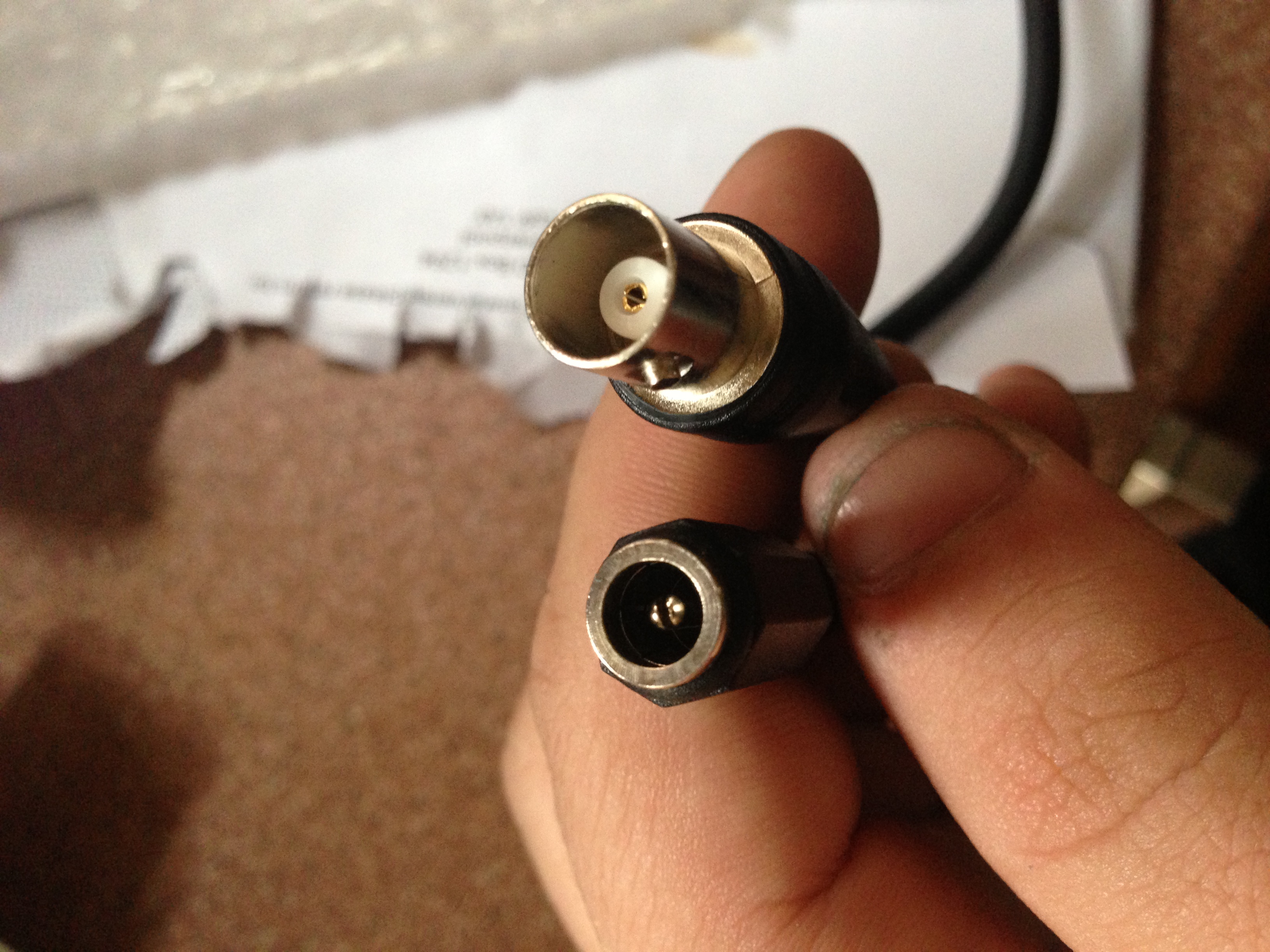

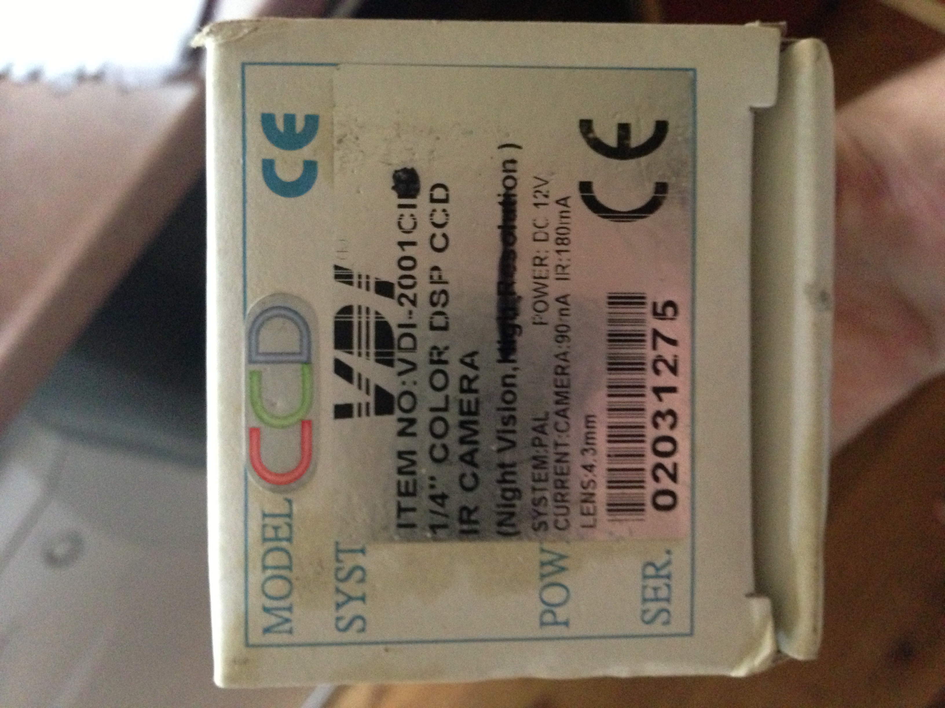

martynball 0 Posted July 10, 2013 Sorry guys I don't know much about CCTV so I don't know where to put this. Could someone explain to me what I hardware I need to connect this camera too and what software. Below is a picture of the connecters for the camera and also the sticker showing the model ect... I just want to connect it to my computer and save the footage to the additional harddrive in the pc. Running windows XP. Share this post Link to post Share on other sites
SectorSecurity 0 Posted July 10, 2013 You need to get yourself a BNC connector and a male power connector, I would suggest if you don't know what these are or how to terminate cables get yourself a premade roll. http://www.tigerdirect.ca/applications/SearchTools/item-details.asp?EdpNo=6391800&CatId=5204 To connect it to your computer you need yourself a DVR capture card. Share this post Link to post Share on other sites
martynball 0 Posted July 10, 2013 You need to get yourself a BNC connector and a male power connector, I would suggest if you don't know what these are or how to terminate cables get yourself a premade roll. http://www.tigerdirect.ca/applications/SearchTools/item-details.asp?EdpNo=6391800&CatId=5204 To connect it to your computer you need yourself a DVR capture card. Thanks, I will look into getting those. Share this post Link to post Share on other sites

joseph.chen0312 0 Posted July 11, 2013 Actually, this is we call F connector not BNC. As for you want to hook up camera to computer, I think you could get one "video grapper" or "Video capture card" Share this post Link to post Share on other sites
SectorSecurity 0 Posted July 11, 2013 Actually, this is we call F connector not BNC. As for you want to hook up camera to computer, I think you could get one "video grapper" or "Video capture card" Then I must have been doing it wrong all these years, because I have been connecting female BNC connectors to those. https://www.google.ca/search?q=F+connector&um=1&ie=UTF-8&hl=en&tbm=isch&source=og&sa=N&tab=wi&ei=JaHeUey-DeOIyAHv5IGAAw&biw=1400&bih=949&sei=J6HeUYH_FMLCyQGHw4C4Cg That is what an F connector looks like clearly different. Share this post Link to post Share on other sites
BIGWRENCH40OZ 0 Posted July 11, 2013 Actually, this is we call F connector not BNC. As for you want to hook up camera to computer, I think you could get one "video grapper" or "Video capture card" Negative. SectorSecurity is correct. Share this post Link to post Share on other sites
SectorSecurity 0 Posted July 11, 2013 Like I said previously his best bet would be to just use a roll of premade cable (as much as it pains me to say that) as this will be the easiest solutions. At the computer you need a DVR capture card, such as the many offerings from Geovision. You will also need one of these. http://www.amazon.com/Security-Camera-500mA-Power-Supply/dp/B002IS47D8 That will provide the power, the capture card will capture and allow you to record the video, and the premade cable has all the required connections. Share this post Link to post Share on other sites
joseph.chen0312 0 Posted July 12, 2013 Hello, Yes you are right. I am wrong at type connector and thank you for your correction. Share this post Link to post Share on other sites
