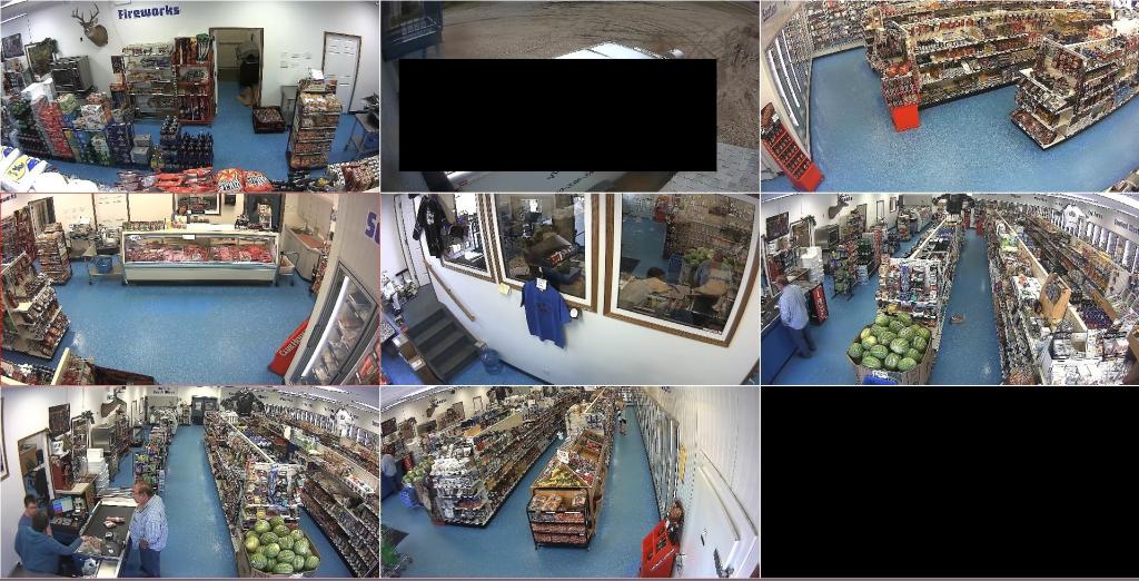

here is example
customer used old coax
to install HD-SDI
Whole retrofit job was done in few hours

here is example
to install HD-SDI

Can you show full size pictures?
Thank you.
Almost full size
