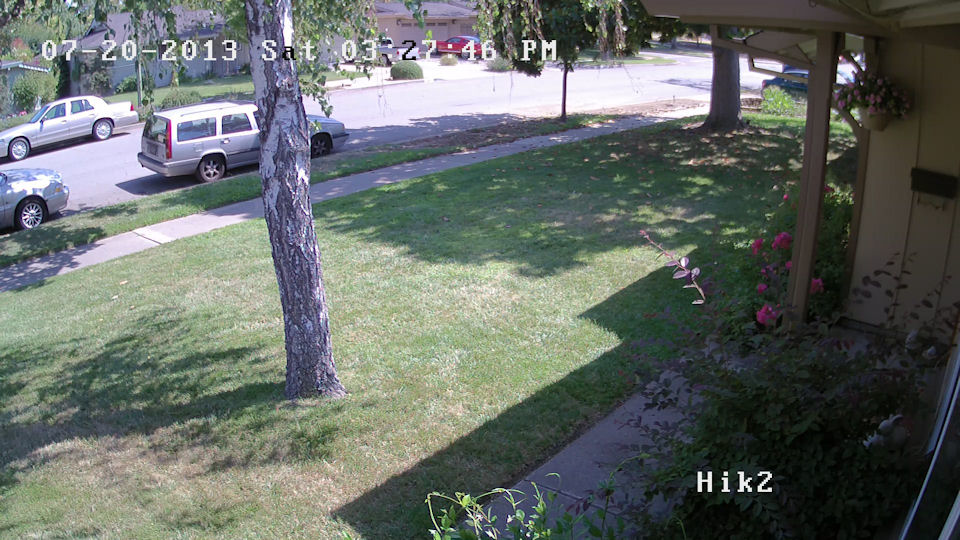

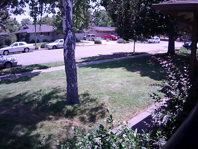

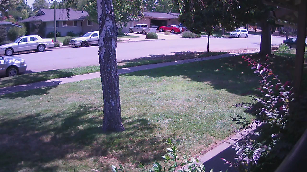

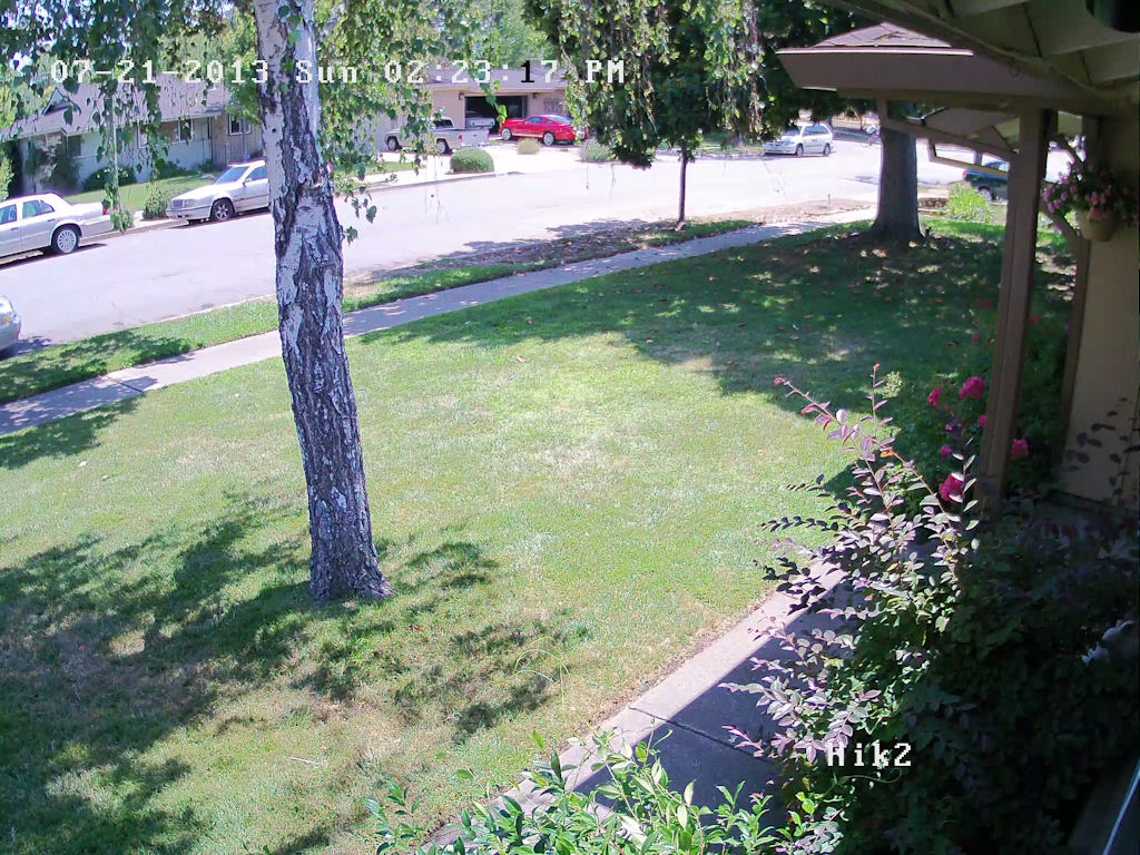

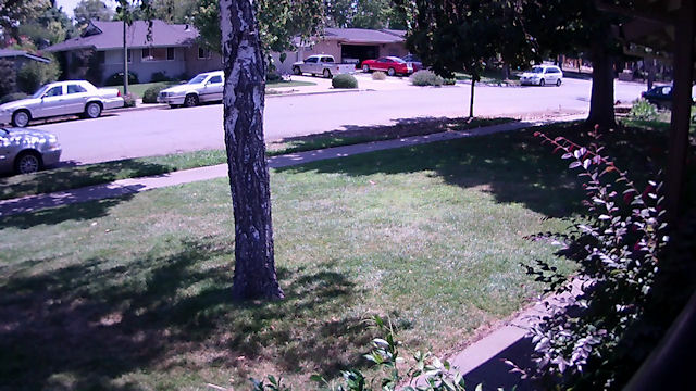

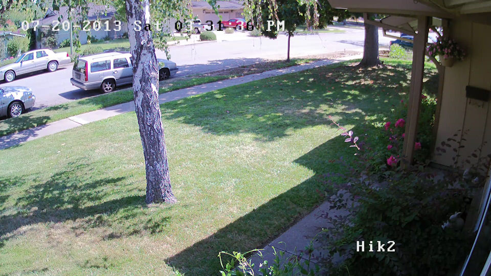

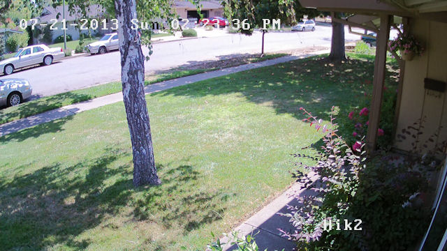

MaxIcon 0 Posted July 21, 2013 (edited) Here are some comparisons, most of them reduced in size 50%. The Dahua is a few feet below the Hik, sitting on a ladder, and the cams are aligned so the image starts at the same point on the left: Hik at 720p, optimized for daytime shadows vs lower night noise - WDR=21, contrast=25: Dahua 2100 at 720p, default settings (no WDR on the firmware version in this cam; I'll have to update it and see if it helps): Dahua 2100 at 1.3MP - same horizontal resolution, more vertical resolution: Hik at 3MP, with the smaller FOV than the 1080p image: Finally, here's the Dahua, full size 720p, with contrast dropped to 40 to try to open up the shadows. Setting it to 25 like the Hik made it completely washed out. This image shows the softness in shadows that was the showstopper for me on the Dahua - it just turns stuff into fuzz. Even the half-size Hik images are better. The 2MP and 3MP Dahuas do the same thing. ETA: Updated for mroek's corrections. Edited July 21, 2013 by Guest Share this post Link to post Share on other sites
mroek 0 Posted July 21, 2013 Thank you very much for taking the trouble to do this! It seems the Hik has approximately the same coverage in the 3MP mode as the Dahua in 1.3MP mode, just as I was hoping. And it is actually a bit wider in the 720P mode than the Dahua, meaning that if I don't need as much VFOV, I can run it in that mode for better HFOV. I gather the Hik has the same FOV in 1080P mode (which you didn't post any shots from) as in 720P, right? Then a few comments to what you wrote: Why do you think the Dahua should have changed HFOV when switching between the 1.3MP mode and 720P? The horizontal resolution is exactly the same, the 720P-image is just cropped top and bottom. No extra interpolation, I think. And you also wrote that there is no WDR on the Dahua. That's not entirely correct, in one of the later firmwares, Dahua added WDR also to the 2100. Mine has it, it's one of the "BLC mode"-options. Share this post Link to post Share on other sites
MaxIcon 0 Posted July 21, 2013 No problem, I enjoy testing the different cams. Yes, the Hik 1080p FOV is the same as the 720p, just fewer pixels. You're right about the Dahua horizontal resolution; I thought it was wider, like the 3MP, but didn't check it, so that's normal. I'll update the post for that. My 2100 doesn't have WDR, and really needs it, so it's probably the older firmware. I'll update it and see how much that helps. Thanks for the corrections! I'll be pulling it apart soon to see why most of the LEDs died. I haven't heard of that happening with other 2100s, and am assuming I got a lemon. Unfortunately, no support for this one, so I'll need to try another LED board from ebay if the one in it can't be fixed. Share this post Link to post Share on other sites

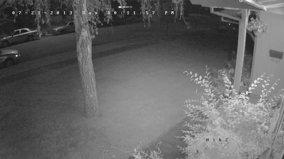

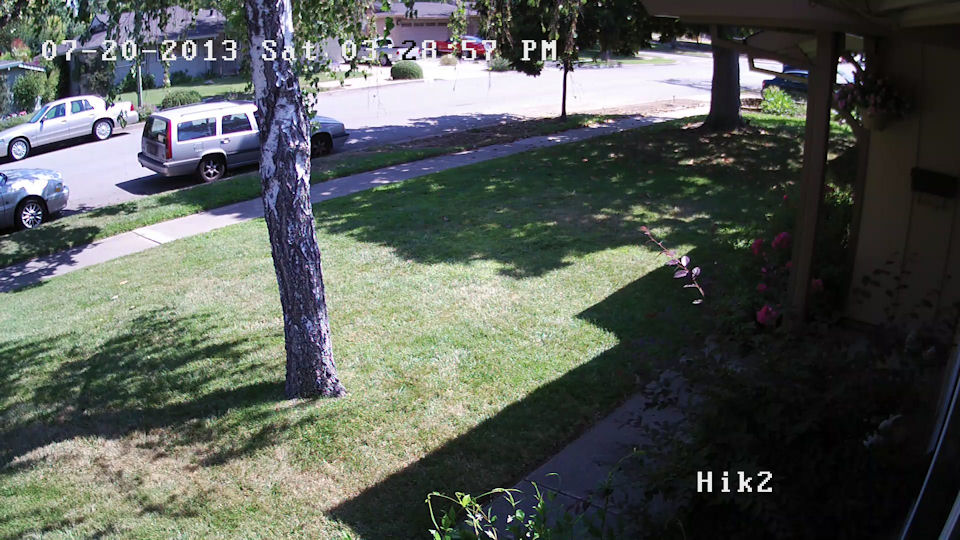

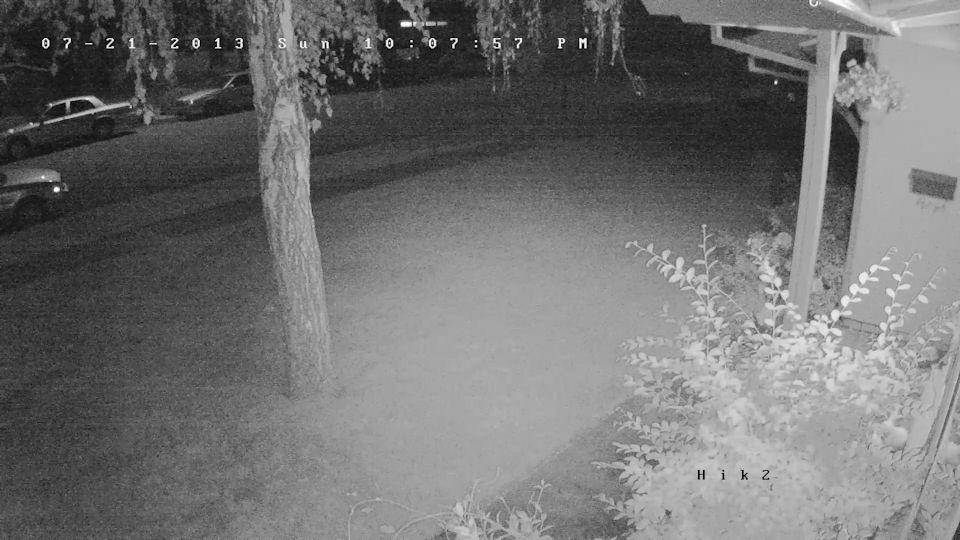

MaxIcon 0 Posted July 23, 2013 (edited) I don't remember seeing corridor mode on there. I have a post here where I've optimized my new quasi-panoramic setup for day and night trade-offs, and it includes using noise reduction for the night shots: http://www.cam-it.org/index.php?topic=4828.0 I've posted a sample of the pics below. The noise reduction helps the Hik night noise a good bit. It does soften the day shots some, but they're still much sharper than the Dahua images, so I'm ok with that. I've only had this setup for a few days, and will get a better feel for it over the next week or so. Here are some of the pics for the local board. All are reduced by 50%. This is with firmware 5.0.0. Hik 3MP bullet, set for 1080p, default settings, bright daytime - it's way too dark in the shadows: WDR works well on this camera in the daytime, and brightens up the shadows, but causes trouble at night, bringing out the horizontal lines that the Hik shows when low-light images get noisy. Here's WDR=47 (what it goes to when you set 50) in the bright sun: After seeing the night images below, I reduced WDR and reduced contrast, which is what we did before WDR if the shadows were too dark. This helped the noise, and turning the noise reduction up to 100 (default is 50) cleared up more of the noise. Noise reduction softens the daytime image a little, but not as bad as the Dahua's default image. I may reduce sharpening next, as that highlights low light noise, but I'll check this out for a bit first. This is WDR=21 (what it goes to when you set 20), contrast=25, noise reduction=100. Night shot, with some local streetlights and house lights, default settings - not much noise, but too dark and no detail when there's no direct illumination: WDR=47; way too much noise: And WDR=21, contrast=25, noise reduction=100 - more details in the shadows, some noise but not too bad. Edited July 24, 2013 by Guest Share this post Link to post Share on other sites
mroek 0 Posted July 23, 2013 Thanks for that link. Looks like noise is manageable with the Hiks also. I still don't like the dynamic coloring of the text overlay on the Hik, but perhaps it will be possible to persuade them to add an option to disable that. In any case, it's not a deal breaker, so I'm going ahead with my order. Share this post Link to post Share on other sites
