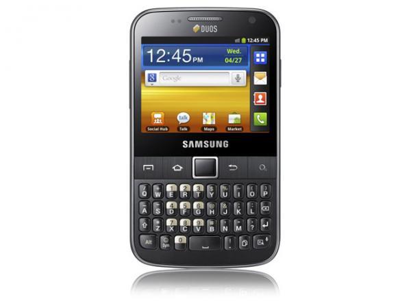

Amigos sou novo aqui no fórum e também no assunto a instalação de câmeras. Aos troncos e barrancos e com muita pesquisa consegui instalar uma câmera aqui na minha residencia para ver meus netinhos do meu celular com a banda larga 3G. O meu celular é este conforme imagem abaixo:
O problema é que eu não vejo a imagem em tempo real como vemos nas câmeras do radar G1 e sim vejo as pessoas em câmera lenta tipo slide. Eu não vejo as pessoas se movimentando em tempo real. Será que preciso de algum programa para o celular?
Eu tenho o velox 2 mega. É velocidade fraca ou isto não influi muito já que consigo ver as cameras do radar G1 normal. Alguém pode me ajudar?

Friends I'm new here on the forum and also on the subject of installing cameras. The trunks and bounds and with much research managed to install a camera in my residence here to see my grandchildren from my phone with 3G broadband. My phone is as this picture above:
The problem is that I do not see the image in real time as we see in the radar cameras G1 rather see people slow motion slide type. I do not see people moving in real time. Do I need some program for the phone?
I have 2 mega velox. Speed ​​is weak or it does not affect much as I can see the cameras radar G1 standard. Can anyone help me?
I would not expect to see good motion video in 3G from a 2MP camera, it is what it is. Some cameras have 2 streams and you can set the second stream to be much lower resolution and frame rate and if your phone app can select the second stream, you'll be happier with the motion and switching to a 4G phone would help a lot. Don't know if that's an Android phone but I use the IP Cam Viewer app and it works well with my cameras and uses the second stream by default.
Also, where your home internet access is, check your network upload speed. You need good internet access to stream video. For example 2MP at 30 frames per second may need 4-8Mbps upload but VGA resolution (640x480) at 15 fps may only need 500Kbps upload.

Eu moro no Brasil.
Instalei o programa IP Cam viewer e acessei atavés do wifi e a velocidade aumentou consideravelmente. Ficou melhor do que em 3G.
