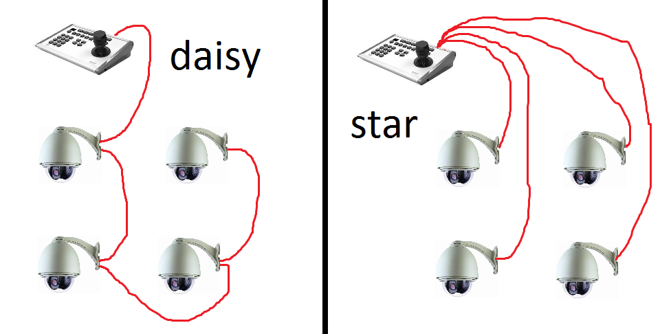

Hi mike, how are the data lines of the cameras wired? star, or daisy?

Thanks guys, they are wired in star. I am trying to check the com-ports, I can not seem to find that info in DS Control Point?
