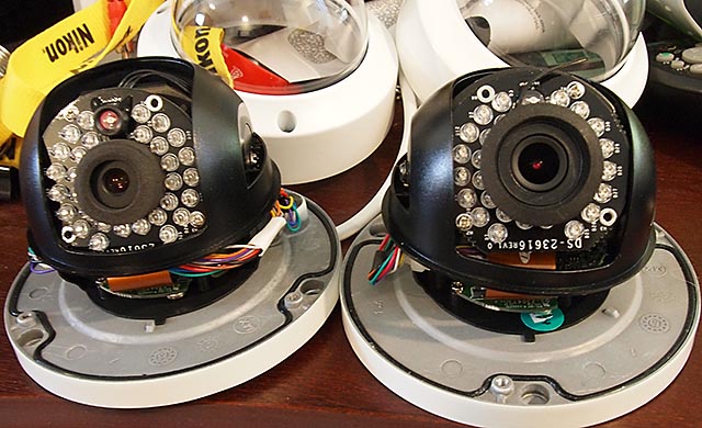

Good luck with those domes, I had serious IR LED light bleed issues until Hikvision changed their manufacturing on these. The new ones work great but may have caused manufacturing delays. Here's the differences between new vs. old. See how the old one covered half the LEDs and the large shape made it hard to conform to the dome's curves. Hikvision was very responsive in getting this resolved once I reported this. One reason my distributor can't get the new ones for about another week or two. They also made changes to the bullet. Also, the old design was a floating ring and the new one is fixed in place.
The Lorex's dome camera
wow thanks for letting us know!
any pics to compare the new and old bullets?
I'm actually surprised that QC could look at the one on the right with many IR covered and say yeah, that passes! The other thing to look for a ease of positioning. You get the perfect fov, put the dome back on, foam pushes against dome and it moves the camera- a vicious cycle ending up with a compramise. Not a huge deal, but a pia.

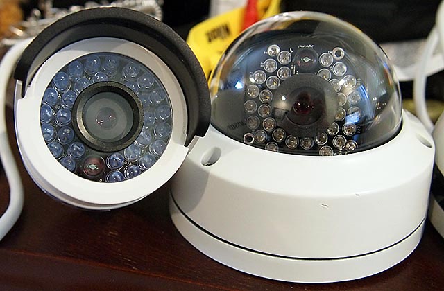

Here's the happy couple, the new bullet and dome together. Notice the bullet now has a ring on the outside of the glass, before it was just plain glass. Again, to control IR light bleed. So to those that want the latest and greatest, wait a little longer for the proverbial slow boat from China to arrive. These I got directly from Hikvision HQ.
What's also cool but not readily apparent is the new domes & bullets have a round waterproof rj45 jack on the pigtail that is much smaller than the original square one. So smaller hole needs to be made and it's waterproof where the square ones were not.
BTW, this is the reason I haven't done a review yet, I was waiting for them to resolve this issue.

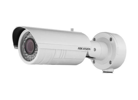

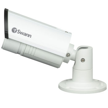

The Swann appears to be this camera:
http://www.hikvision.com/en/us/Products_show.asp?id=7673
2.7 ~ 9mm @F1.6, angle of view 101° ~ 30.4°.
They don't match the spec you mention, but this isn't uncommon.
This also shows up as a 12W max camera, which is a good bit higher than many recent models. It's possible this is the max load when the motorized focus is moving, but would require testing to know for sure.
You're right, the Costco version looks like a mini version of the Hik linked. I don't see the smaller version on the Hik pages, but they're pretty clearly related. The Hik's got a junction box and is a bit longer. The Costco spec shows 2.8 – 12 mm, but no power consumption that I can see.
