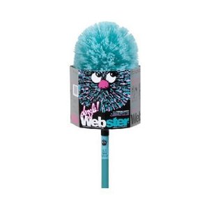

For spider webs, I use the Webster, which is soft enough to not move the camera and designed for spider webs. I've only got one floor, though. You can get them at Amazon.
