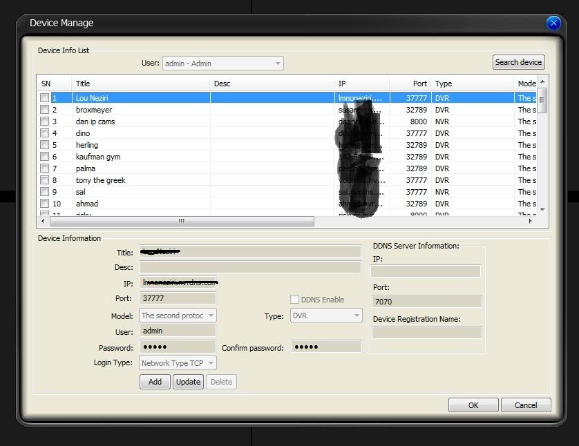

Silly question here, but did you change the username and password in device manager in PSS and save? PSS logs into your dvr just like anything else. It does not automatically do it just cause your using it as a monitor, rather than a recorder.

The login for the pss software has nothing to do with the log in for the dvr. You need open pss, than click on device manager, than edit your device(dvr). In your device setting, enter your new username than password and make sure you enter it in confirm. Than make sure you click save, not OK. Wait for a few seconds after you click save, than when it releases, click OK. Than goto devices on the top and try to log into your system.

Are you even going in device manager like I said? I tried to be very specific on what you have to do to make it work. In device settings, you enter the dvr's username and password and there is two areas to enter the password. The second area says confirm. That's what I mean to make sure you enter it in confirm password.

OK, this is weird. Do you get to this screen? Than click update, enter your new username and password, confirm password, than click save?
Ok, I understand this and belive me I have fixed this on my NVR at home wich I was playing with few weeks ago and like now lost connection with few IPC2100 cameras (wasn´t able to view with PSS ) .
