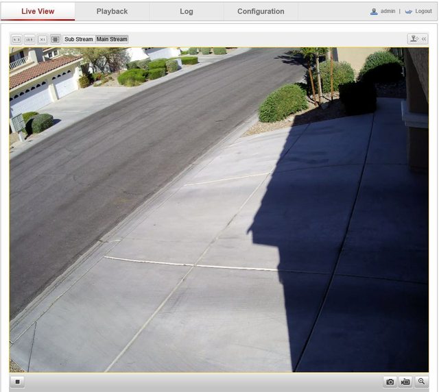

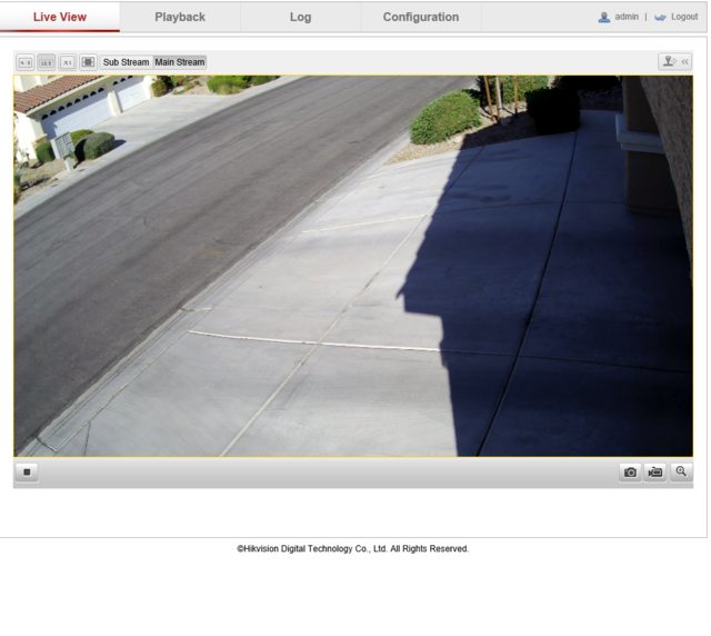

BigCarbs 0 Posted November 16, 2013 Cascadian said: MaxIcon said: These cams have a smaller horizontal FOV on 3MP than 2MP, as well as a 4:3 aspect ratio compared to the 9:16 aspect ratio of the 2MP, so if you had a need for either of those, the 3MP would be useful. If you want the HD aspect ratio or the wider view, 2MP is better. Is it true that 3MP is showing less than 2MP, and not the other way around? I would think that the 3MP image extends the vertical FOV, not shrink the horizontal FOV... Or is it a mixture -- it both shrinks the horizontal FOV and increases the vertical FOV? Yes it's a mixture. Here is one of mine on 1080 vs 3mp 1080 3MP Share this post Link to post Share on other sites
SB_Jim 1 Posted November 16, 2013 My quick look.. says that there's more vertical difference (change) than horizontal. But that's just my view. Share this post Link to post Share on other sites
BigCarbs 0 Posted November 16, 2013 Absolutely, I prefer the 3mp for additional coverage, the 15fps is no problem. Share this post Link to post Share on other sites
